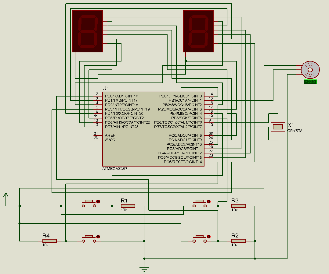

i have a custom avr atmega328 board to which two seven segment, a servo and a crystal with capacitor is attached. when only the seven segment is connected, the microcontroller works perfectly.But when i attach the servo along with the seven segment, it starts blinking very rapidly and the servo moves to the extreme end. i have programmed the servo to rotate 0 to 90 and then 90 to zero and the seven segment to show its angle. My code is fine, i have verified it using the arduino. i guess the crystal is causing some interference or there is anything else needed for the pwm operation that i am missing to use the servo. can anyone help me out...??????.....please!!!

    Where is the power for the servo coming from? A diagram of connections would help greatly. a meter showing current would help if you have one handy. Clem

    Can you provide schematic to show how everything is connected and also the sketch, this will allow us to hep you better

    rishi2628 over 10 years ago in reply to clem57
    i have a nine volt battery, that i have attached to a 7805 ic. the output from this ic is connected to both the microcontroller and the servo. both are connected parallel

    rishi2628 over 10 years ago in reply to Robert Peter Oakes
    here is the schematic.................i tried simulating it......................the pwm pin (15th pin) is continuously on in the simulation ............. but when i make the same circuit using an arduino.............it works perfectly.image
    let me tell you what the buttons do.................the top left button is for the left seven segment and similarly the top right button is for the right seven segment. the down left button is reset and the down right button is set..........when set is pressed what ever number is being displayed on the seven segments lets say 7 and 2 the the servo would move to that angle that is 72..................i can also upload the code if you guy want............and i do want to emphasize the fact that when i assemble this circuit using an arduino, it works perfectly and incase you are wondering that the capacitors on crystal are missing the let me tell you i have attached the 22pf capacitors..............now please anyone tell me whats the problem!!!!!

    gadget.iom over 10 years ago in reply to rishi2628
    Well a lack of capacitors on the crystal immediately raise concerns. The reliable timing of your PWM will most likely rely on capacitors being in place.

    rishi2628 over 10 years ago in reply to gadget.iom
    i have attached the capacitors...22pf.....i just forgot to show them in the schematics
