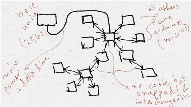

Hello all,
I am trying to talk to multiple (say 4) microcontrollers (Arduinos) at the same time. I was wondering if i can setup a serial connection, with a selection line that can detect the neighbor Arduino and enable the corresponding pin to start the serial communication between the two. something like this:image

  • michaelkellett
    0 michaelkellett over 10 years ago in reply to Former Member
    Almost certainly the best way (cheapest and easiest) to implement this network is with a single RS485 link connecting all the devices together. This will allow you to use the hardware UART on the Arduino.
    One of the devices needs to be a master but all the bus information is available to any connected device.
    I don't think any standard protocol will work that well so you will need to invent your own.
    If we do the sums for 32 nodes it looks like this:
    115200 baud communications, 32 nodes, = approx 360 bytes per second per node, let's assume that we due to switching overheads and timing guard bands we only get  256 bytes/ per mode per second, so if each message is 8 bytes long you could have 32 messages per node per second - if one byte of the message is ID and another is a check sum  you get 6 bytes of data per message - if this isn't enough you can increase the baud rate to 250000 but you will have problems if you try to go much faster.
    Roughly the way the protocol would work is that the master would send out a synch message every 'frame' time (about 32 times per second in this example) and the slaves would each transmit their own little packet of data at their allotted time (which they could calculate from knowing their address) - this way only one slave ever talks at a time, each slave only needs to listen for a short time when it expects the frame synch message from the master (or at other times too if it wants more data.) So each slave only needs 2 interrupts per frame time - or 64 per second which will be a much lower software overhead than trying to run 6 software UARTS.
    You'll need to spend quite a lot of time working on the protocol to get it right but you can re-assure yourself that it is viable in principle since a similar scheme is used with supermarket shelf edge labels (using very low power radio links not wire) in systems with thousands of nodes. One of the issues you need to resolve is network discovery - when you switch the system on the master needs to work out how many nodes are attached and what their addresses are.
    I don't know why you are using an Arduino for this - it totally not the ideal processor - you would be far better off using an ARM Cortex based chip which would give you much more processing power for similar cost.
    MK

  • Former Member
    0 Former Member over 10 years ago in reply to michaelkellett
    well may be I am misunderstanding your point. but what you are suggesting is a main bus line with units connected to it. However if i may give a more complete diagram of the problem, here it is:
    now please consider the fact that this system is a mesh, not a bus,not just a star.
  • michaelkellett
    You are confusing the the physical topology with the logical topology.
    My suggestion is that the devices are physically connected in parallel (not star !!!) and they can be logically connected any way you like (depends on protocol.)
    But you still need to say how many nodes you might need (parallel connection has a limit on the maximum). A physical mesh network has no physical limit to the number of nodes but will run n into issues with the time taken for data to propagate through it and the volume of data running through "pinch" points in the mesh.
    Mesh networks can work well when most data transfer is between devices which are close together. If most of the data goes from nodes to base unit then the mesh network performs worse than the parallel bus connection - the data flow is limited by the speed of a single link but the processing overhead is much greater.
    MK
  • Former Member
    Michael, the number of serial connections is a max. of 6.
    However, as part of the requirement, a unit may communicate with the base unit directly or indirectly through another unit. the physical and logical topology are congruent, in the case of this project. but why is this a confusing point? true! I mentioned star as the topology I was suggesting. Could you, however, draw a rough sketch to show the point more clearly?
  • michaelkellett
    You still are not answering the key question  - what is the maximum number of nodes in the system ?
    With a parallel physical connection ANY logical topology is possible. Any device can talk and all devices have the option of listening - the only requirement is that only one device talks at a time. If one device takes the data from another, processes it and then transmits it again this is exactly the same logical effect as one node passing data directly to another node which then passes it to a third.
    MK
    0 shabaz over 10 years ago in reply to michaelkellett
    @karim think of it like those folding plate puzzles (Rubik's magic). Many physical topologies are possible but they are still all connected using the same string (wires). Or think of squares with the same connection brought out to all four sides.
