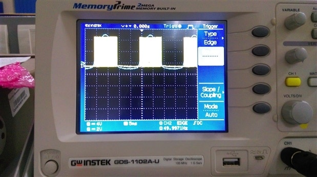

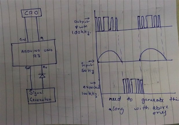

a sine wave is applied at a0 using a diode,so that it geets rectified and then after pwm the square obatIned is only with wrt positive cycle ,i need to generate pwm  even during negative cycle and one way is to do it by full bridge rectifier .so is there any way by arduino coding i could get it

                                                                                              from the signal generator i have  provide a supply of  5 v pp and 50 hz frequency, +ve part provided to the  diode and the diode is connected to the  a0 pin in the arduino uno  and-ve part of signal generator to ground the .then is have taken output from 9 pin and at this point i am getting pwm of  only +ve cycle of sine wave input as reference(as i have used a diode)image
    now i need to generate pwm of -ve cycle
    1. i want arduino code to store the +ve cycle pwm wave  in other pin and then during -ve cycle i want to output it through this pin .by this i would get  pwm for both +ve and -ve cycle of sine wave  and  it would be helpful if any way is there to distinguish the pwm for +ve and -ve cycle
    2 in a simple way i need to generate a pwm for -ve cycle and need to do it by arduino code only and not by rectifier (less circuit part  and more part must be done in coding)
    any way u could help me to do this it would be of great help. image

    0 Former Member over 9 years ago in reply to clem57
    We need to send same values of PWM to negative cycle. If we measure negative supply, output will be zero as diode blocks negative supply. We need to send psuedo values to negative cycle.
