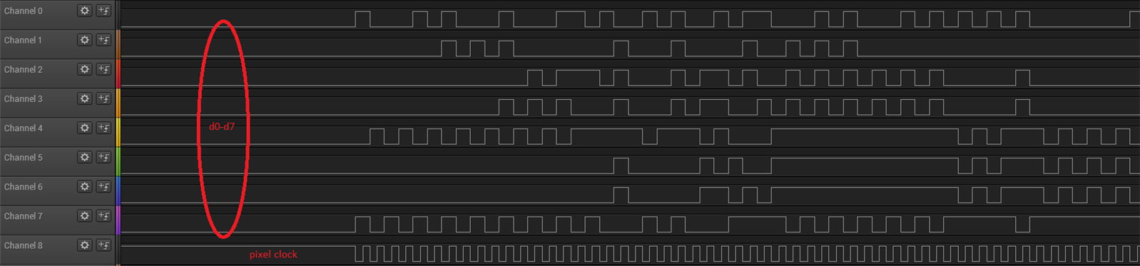

I have been trying to get some useful data from the OV7670 camera module but it seems that it is not outputting the correct data. I have been using this code: https://github.com/ComputerNerd/ov7670-no-ram-arduino-uno and everything seems fine from a software point of view but what I am getting out is not as expected. With the lens covered I should get a stream of repetitive data like [0,80,0,80,0,80....] but I dont regardless of whether it is covered or not. I have tried various register settings and still no joy. Even with default register settings I should be able to see a basic image. I have also viewed the data from the device on a logic analyzer and it is clear that the data is random. The pic below is the camera module output data with the lens covered and it can be seen that the data is totally random.
Anyone know why this is happening or has seen it before?

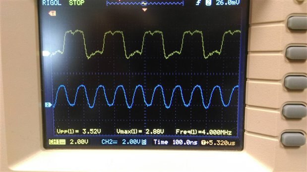

    Below is a capture from the oscilloscope. Blue is the pixel clock and yellow is one of the data pins. I was clocking the logic analyzer using a trigger from inside my code when the HREF went high. As you…

    0 shabaz over 9 years ago in reply to Former Member
    What did the waveforms look like on the scope? Any noise or glitches on the oscilloscope analog traces?
    Do you have a screen grab from oscilloscope analog traces (not logic traces).
    How was your logic analyser configured? Clocking on the pixel clock, or free-running capture from the logic analyzer's own clock?
    Also a photo of the setup would help.

    Also, is it an assumption that the data is random, or have you checked?
    i.e. can you plot it in a graphic view (an entire frame if possible), to see if there is any signal in the noise?
    It doesn't look entirely random to me. I can see the most significant bits alternated on every other byte for the first 16 bytes. It is to be expected for the least significant ones to possibly have variations due to sensor noise.
    I don't know what format is expected, but it doesn't appear random.
  • Former Member
    0 Former Member over 9 years ago in reply to shabaz
    As you say the MSB alternates to begin with but the rest seem to be way to random. For a 2 byte pixel for a black image they should repeat every 2 bytes but clearly doesn't.
    Hi Mark,
    You're triggering on HREF, but once triggered, is the data captured by your analyser based on the pixel clocking in the data into your analyser, or based on an internal oscillator inside the logic analyser capturing at a higher rate? There is a difference, and it would help to know which one. If the latter, what clock rate are you capturing at?
    Also, the data snapshot on your oscilloscope isn't random. Could you plot the image for an entire frame?
    Perhaps AGC is kicking in, or some bursts of noise that partially affect the image, or misconfigured registers could be having an unusual affect.
