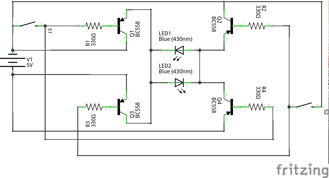

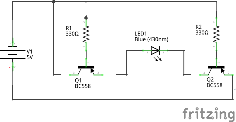

I'm trying to learn about transistors and H bridges towards a final goal of controlling a bipolar stepper motor with Arduino.
I've done the following half H-bridge in the process of learning:
My first question: Why can't I use a single resistor to connect the base of both transistors to ground?

    I'm not sure that this schematic works... the led isn't reverse polarized? Anyway use a pnp as pullup transistor and a npn as pulldown, it's a good thing to put also a limiter resistor to control the current…
    Anyway use a pnp as pullup transistor and a npn as pulldown, it's a good thing to put also a limiter resistor to control the current that flow into the led.
    In your schematic you can't wire together bases because they are at different potential (b1 has a voltage of about 4.3V, b2 5-Vec2- Vled-0.7)
    I suggest you to take (from internet or a book) a schematic of a full bridge and study how it works from there.

    0 ovidiub13 over 10 years ago
    Thank you for your feedback.
    It works.
    I've read about how H-bridges work. I understand the general concept. What I'm having issues understanding is how transistors work. Here I'm just using them like switches.
    What I've shown previously was, as I've said, half an H-bridge.
    Here's the full H-bridge:
    I've tested this on my breadboard and it works ( I can make a video if necessary).
    What I've noticed on the full H-Bridge is that I have 2,77 V on LED1 and 3,40 V on LED2. I don't understand why. SInce the two halves are basically mirrored, I expected them to be the same.

  • strb
    0 strb over 10 years ago in reply to ovidiub13
    Yes you're using it like switch but in the wrong way, q1 and q2 can't reach the saturation region and burn more power.
    Hint: the arrow in the emitter show you the direction of the current, the same is for diode, than take a look to your first schematic and you can easily see that the led is connected wrong because current can't flow in both direction.
    It's hard to explain here how bjt works, try to take a look here https://en.wikipedia.org/wiki/Bipolar_junction_transistor , don't read the physical functioning, you have to learn just the relation between base/collector current/voltage.
    The full bridge works but probably you're turning on the "wrong led" when you push a button, try to use two different coloured leds.
    You have to know how basic components work before doing anything, simply because it's hard to do something right if you don't know how it works.

    0 mcb1 over 10 years ago in reply to ovidiub13
    You can consider a transistor as a switch (in this case they are either ON or OFF)
    The control part of the switch is the base to emitter (NPN) or emitter to base (PNP) junction.
    This usually requires 0.6v across it to 'switch' on the Collector to Emitter (NPN) or Emitter to Collector (PNP) junction.
    When in the 'ON' state the C-E/E-C is as low as 0.2v or less in larger devices.
    In your half bridge circuit, when you switch S2 on, there is current flow from the +ve through the E-B of Q3 thru R3 and S2 to ground.  ... image
    Q3 is switched ON and current is able to flow through the E-C of Q3, thru LED2 and appears at the Emitter of Q2. ....image
    Current will flow via Q2's E-B, R2 and via Switch2 to ground BUT .... as soon as Q2 turns ON the E-C of Q2 will reduce the voltage to 0.2v at the emitter....image
    Q2 will then be OFF.
    It is likely that the circuit will adjust itself to end up with 0.6v at the Emitter which is not ideal.
    BUT the real biggy here is you have effectively dumped 5v across a poor led with no series limiting resistor, which tends to make them very bright for a millisecond.
    You really need to add a 220 ohm resistor in series to stop them being destroyed.
    The only thing saving your leds and giving the illusion of the circuit working is that Q2 is not turning on and the led current is flowing through the E-B and 330 ohm resistors.
    Please note
    I have only described one side, but the same could be considered for the other half.
    We all start learning somewhere so trying to understand is a great way to learn ...well done.

    0 Robert Peter Oakes over 10 years ago in reply to ovidiub13
    As others have said, the reason for different voltages is that different coloured LEDs drop a different voltage across them for the same current, LEDs are current devices. in your circuit as mcb1 has said, i'm surprised the LEDs have not burned out, either the batteries are limiting the current or the gain of the transistors is insufficient with 330R base resistor to allow the full current to flow, wither way the LEDs are being driven badly.
    If you do not yet understand transistor then start with that, not an H Bridge. in all cases above you are using the transistor as a switch, and you need to know what that means first. Then build on that to a Half bridge, then a Full Bridge
    I would also suggest looking up how LEDs work as well as without that knowledge you will be burning  a few out in short order image
    Making smoke is not a bad thing, we learn a lot from it (Making mistakes is more educational than everything working first time) but all of the devices in the schematic you have above have limitations and you need to understand them in order to work within them (Prevent the Blue smoke of learning image )
    Data sheet for the BC558:- https://www.fairchildsemi.com/datasheets/BC/BC560.pdf  shows a max current of 100mA and a volt drop of between 200 to 600mV across the transistor and you have 2 transistors and an LED across the supply
