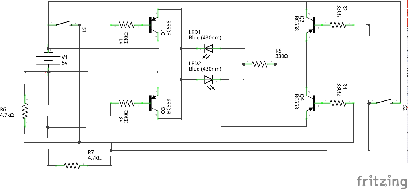

I'm trying to learn about transistors and H bridges towards a final goal of controlling a bipolar stepper motor with Arduino.
I've done the following half H-bridge in the process of learning:
My first question: Why can't I use a single resistor to connect the base of both transistors to ground?

    I'm not sure that this schematic works... the led isn't reverse polarized? Anyway use a pnp as pullup transistor and a npn as pulldown, it's a good thing to put also a limiter resistor to control the current…

    mcb1 over 10 years ago in reply to ovidiub13 +1 suggested
    What I'm having issues understanding is how transistors work You can consider a transistor as a switch (in this case they are either ON or OFF) The control part of the switch is the base to emitter (NPN…
    0 mcb1 over 10 years ago in reply to Robert Peter Oakes
    i'm surprised the LEDs have not burned out,
    That is because 5v - 0.6v( E-B of Q2) thru 330 ohm is at most 13mA.
    If you factor in a LED forward voltage drop of 1.7v you have 2.7v thru 330 is 8mA.
    I can't see that Q2 even turns ON as it would turn off immediately.

    I fixed it. I think.
    I've added a resistor for the LEDs, and 2 bigger resistors for the transistors bases to + to make sure the gates are closed when the button is not pressed.

    0 mcb1 over 10 years ago in reply to ovidiub13
    I can't recall you indicating that it stayed ON at any point ... maybe I missed it.
    But adding the 2 x 4k7 resistors are good practice.
    If you've been reading our replies, you'll note that Q2 and Q1 never switch ON.
    You can prove this by shorting the Emitter to Base of Q2 and Q1 and you'll find it works exactly the same.

    There are likely many errors in this circuit but it is difficult to follow because the parts are thrown together on the schematic not even resembling a H-bridge formation since the left side has its ends folded back on itself (why?).
    I can't follow the circuit the way it has been drawn (if you've already studied H-bridge circuits which you say you have, then you know that yours is drawn as a mess - not something to show to teachers perhaps if you're a student), so I can't spot all the errors without more effort.
    However, one negative is that you're using 4 identical BJT's.
    There is close to a 1V drop loss for lower legs of the H-bridge (and by lower I mean the ones at the bottom if you'd drawn it the correct way up rather than up-side down), plus about 0.2V for the top legs of the H-bridge, so there will be less than 4V available to the LED or motor. As people have mentioned, if you're using LEDs then there should be a series resistor for them.
    The circuit would be better if the lower BJT's were NPN. Or even better if MOSFETs were used.
    And won't work (well or for long) with inductive loads. If you google H-bridge, you'll see how people resolve that.

    How can I fix this? How can I make them work?
    prove my point by shorting out the E-B first to confirm the suspicion.
    A quick check using Google shows this.

    shabaz is quite right that your circuit is not designed for inductive loads, and there are plenty of simple IC's that take all the hard work out of it for you.

    I did look at you links, but it relied on 4 seperate inputs, and given the issues the OP had, I felt he needed something closer to his circuit.
    The other danger with two seperate switches, is that if both are on .... bye bye transistors.

    of course the Vf of the Blue diode is more like 3.2-3.8 and we have 2? junctions worth of drop between 5V and GND so even less current all told
