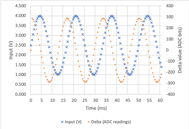

    Hi Cris, don't these things always turn out more interesting than you expect when you have a look at them?!
    Here's what I've come up with....
    My idea was basically to sample the voltage quite quickly (I think you're looking at 60Hz mains), so we get a good number of readings, and work out the difference between the latest reading and the previous one, effectively differentiating the signal. For a sine wave inout, that would give us something like the samples in the graph below (assuming you've got your input scaled nicely in the middle of the Arduino's 5V range).
    From the orange dots showing the delta, you can then see that you're effectively after the zero crossing of the delta signal to get at the peak.
    When I came to try it, I got quite a lot of noisy triggering when there was no signal there, so I've added an extra check to make sure the ADC reading is above 800 before triggering, which is about a 3.9V input signal.
    The (moderately) interesting bit is that to get some good sampling, I set up an interrupt routine using Timer1, so we've got 2kHz sampling out of an Arduino! It's based on some other code I found on a forum some time ago, hopefully it'll be of use!

    I hooked this up to my Arduino Micro, with the signal generator connected between pins GND and A5, with a 3Vpk-pk sine wave signal and 2.5Vdc offset, at 60Hz.
    So there you go - hopefully you can replace that serial output part in the loop() function with what you need to drive your relays, and you're done!
