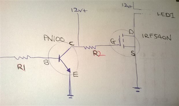

One of the directors has asked me to create a special backdrop for our college musical. This particular backdrop has a particular design (see below) that includes LED strip lighting to give the feel of a 1920s casino sign – similar to what is seen today in Las Vegas.
I  have done up a detailed design for this sign, based off the rough sketch given to me by the director and the dimensions of the backdrop.  On this diagram, the arrangement of the LED strip lighting can be seen.
The LED Strip lighting that will be bought for this project will be sourced from Jaycar – “Low Cost 5m Flexible Adhesive LED Strip Light – Warm White” (ZD0577).  According to the specifications off Jaycar’s website, these LED lights need 1.1 Amps per metre @ 12 volts.  This means that the longest segments of lights need 1.1 * 1.5 = 1.65 Amps of power (rounded up by 20% for safety: 2.0 Amps @ 12 volts).
This would not be an issue if I was just turning these LED Strips on and off with mains power BUT I want to control these LEDs via an Arduino, so that they can do fancy things like flash and chase.  That means that I would need a circuit to control these lights with an Arduino so that everything remains safe and does not blow up.
I have come up with this circuit (below) using a couple of NPN transistors and two power supplies.  In the diagram below, I am aware that the transistor pinouts are EBC.  The ones I am going to buy have a pinout of BCE.
The only problem with this is that I have very little understanding of transistor circuits.  What this circuit has to be able to do is:
  • Using the smallest amount of current from the Arduino (at 5 volts) or a Raspberry Pi (3v3 volts), turn on the circuit to allow the 12 volts that powers the LED strip lighting to flow.
I was thinking of using either TIP41C NPN Transistors (in a darlington Array) or TIP122 NPN transistors.
This circuit will be replicated 8 times over to accommodate for the number of LEDs I am controlling.
Can anyone help me:
  1. Design a circuit that will work 100% and will be safe (ie: low heat)
    1. This includes base resistance
  1. Confirm which transistors I should be using for this project.
Any help will be much appreciated.

    I think the Gate would  be pulled up ok Doug, just that in the off condition the gate would just kinda float there, not so clever !!
    Also this arrangement inverts the logic of the Arduino so to set the LEDs on you need a logic 0 on the  Arduino PIN and vice versa

  • wallarug
    0 wallarug over 12 years ago in reply to dougw
    cool. So 2.2k resistor should be good??
  • Problemchild
    0 Problemchild over 12 years ago in reply to wallarug
    I think you'll find it barely matters it's an order of magnitude thing. The Whole thing has a wide lattitude of working.
    Do not that the logic is inverted though!

  • wallarug
    0 wallarug over 12 years ago in reply to Problemchild
    Hey John / Doug,
    1. How do I overcome the reversed logic or do I just live with it?
    2. Also, what program do you use to make the schematics?
    0 dougw over 12 years ago in reply to wallarug
    You could add another 2N7000 (and a second pull-up resistor) in front of the first 2N7000 but it is cheaper to invert in software.

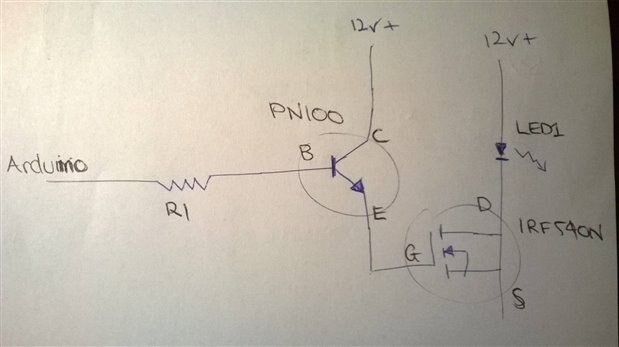

  • wallarug
    Could I use a NPN transistor instead?
    If it is only going to be outputting about 200nA (or an amount so small) for the MOSFET, then the current used by an NPN transistor with a gain of 100 would be miniscule.  <-- Am I right in saying that?
    Suggested Schematic (please correct me if wrong):
    BTW:  Source is going to GND
    Let me know your thoughts.
    Yes, but to invert, the collector should connect to the gate and emitter to ground. Plus you need a pullup resistor on the collector/gate.
  • wallarug
    Above.
