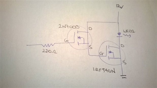

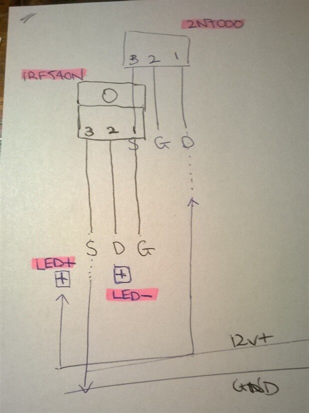

    0 wallarug over 12 years ago
    Hey guys.  I think the below is the go, can you please let me know if there is any issues (I have NOT got the parts yet).
    Note: The LED strip is represented by a single LED.
    Bread Board concept drawing based off pin outs of 2N7000 and IRF540N:
    EDITED: 9:20pm 20th May 2014

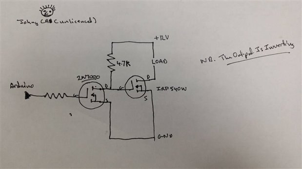

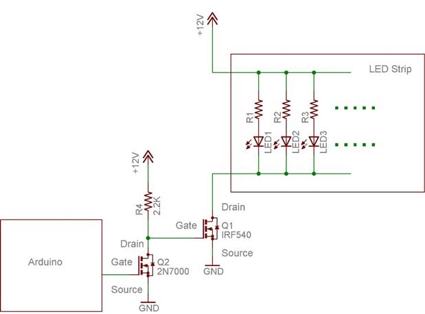

    0 dougw over 12 years ago in reply to wallarug
    This configuration doesn't help the IRF540 turn on more completely, because the gate probably does not get to a high enough voltage and it might not turn off completely either. This is what you would do with bipolar transistors but not FETs.
    For FETs...
    To take full advantage of the 2N7000, its source should be grounded and its drain connected to the gate of the IRF540.
    To turn on the IRF540 completely, its gate should have a pull-up resistor to 12 V. Something like 4.7K should be adequate.
    This arrangement will invert your output signal - when low the LED strip will be on.
  • wallarug
    0 wallarug over 12 years ago in reply to dougw
    I kind of understand what you are saying. Would you please be able to draw up a quick schematic showing what you talked about before??
  • Problemchild
    0 Problemchild over 12 years ago in reply to Problemchild
    I think Douglas means like this:
