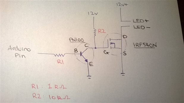

One of the directors has asked me to create a special backdrop for our college musical. This particular backdrop has a particular design (see below) that includes LED strip lighting to give the feel of a 1920s casino sign – similar to what is seen today in Las Vegas.
I  have done up a detailed design for this sign, based off the rough sketch given to me by the director and the dimensions of the backdrop.  On this diagram, the arrangement of the LED strip lighting can be seen.
The LED Strip lighting that will be bought for this project will be sourced from Jaycar – “Low Cost 5m Flexible Adhesive LED Strip Light – Warm White” (ZD0577).  According to the specifications off Jaycar’s website, these LED lights need 1.1 Amps per metre @ 12 volts.  This means that the longest segments of lights need 1.1 * 1.5 = 1.65 Amps of power (rounded up by 20% for safety: 2.0 Amps @ 12 volts).
This would not be an issue if I was just turning these LED Strips on and off with mains power BUT I want to control these LEDs via an Arduino, so that they can do fancy things like flash and chase.  That means that I would need a circuit to control these lights with an Arduino so that everything remains safe and does not blow up.
I have come up with this circuit (below) using a couple of NPN transistors and two power supplies.  In the diagram below, I am aware that the transistor pinouts are EBC.  The ones I am going to buy have a pinout of BCE.
The only problem with this is that I have very little understanding of transistor circuits.  What this circuit has to be able to do is:
  • Using the smallest amount of current from the Arduino (at 5 volts) or a Raspberry Pi (3v3 volts), turn on the circuit to allow the 12 volts that powers the LED strip lighting to flow.
I was thinking of using either TIP41C NPN Transistors (in a darlington Array) or TIP122 NPN transistors.
This circuit will be replicated 8 times over to accommodate for the number of LEDs I am controlling.

    0 dougw over 12 years ago in reply to wallarug
    closer, but the resistor should go between 12V and the gate which is connected directly to the collector.
    The collector should only be connected to the gate and the resistor - not directly to 12v.

    0 wallarug over 12 years ago in reply to dougw
    The trick is understanding what a pull-up resistor is for image.  Helpful link: https://learn.sparkfun.com/tutorials/pull-up-resistors/what-is-a-pull-up-resistor

    0 mcb1 over 12 years ago in reply to wallarug
    Datasheet
    According to the datasheet, you apply a voltage between the Gate and Source and it conducts.
    Hence
    A logic 0 on the Arduino pin will make the LED illuminate.
    Doug suggested a 2k2 resistor to drive the FET, hence R2 should be 2k2.
    or swap R1 and R2 values
    mark

    0 wallarug over 12 years ago in reply to mcb1
    Ok, I shall change the resistor values to:
    R1: 1k
    R2: 2k2
    That should be enough (I hope).   BTW:  What did this post mean by Doug:
    Yes, but to invert, the collector should connect to the gate and emitter to ground. Plus you need a pullup resistor on the collector/gate.
    I thought that would invert the logic?
    I think Doug might have been referring to the drawing above the post ....
    In the drawing Doug provided, a high on the Arduino pin turns off the LED.
    Hence you set the output as HIGH in the startup, then whenever you want to turn the LED ON you make the output pin LOW.
    Each output is either ON or OFF, its just how you use it.
    I'm sure it won't be a problem to invert it in software.
    Definitely not!  Especially when it hasn't even been written! image
    I shall remember to invert the software when I eventually get round to writing it (once I have the board working).
