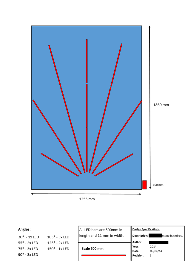

One of the directors has asked me to create a special backdrop for our college musical. This particular backdrop has a particular design (see below) that includes LED strip lighting to give the feel of a 1920s casino sign – similar to what is seen today in Las Vegas.
I  have done up a detailed design for this sign, based off the rough sketch given to me by the director and the dimensions of the backdrop.  On this diagram, the arrangement of the LED strip lighting can be seen.
The LED Strip lighting that will be bought for this project will be sourced from Jaycar – “Low Cost 5m Flexible Adhesive LED Strip Light – Warm White” (ZD0577).  According to the specifications off Jaycar’s website, these LED lights need 1.1 Amps per metre @ 12 volts.  This means that the longest segments of lights need 1.1 * 1.5 = 1.65 Amps of power (rounded up by 20% for safety: 2.0 Amps @ 12 volts).

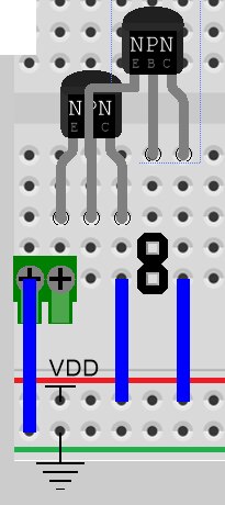

I have come up with this circuit (below) using a couple of NPN transistors and two power supplies.  In the diagram below, I am aware that the transistor pinouts are EBC.  The ones I am going to buy have a pinout of BCE.
The only problem with this is that I have very little understanding of transistor circuits.  What this circuit has to be able to do is:
  • Using the smallest amount of current from the Arduino (at 5 volts) or a Raspberry Pi (3v3 volts), turn on the circuit to allow the 12 volts that powers the LED strip lighting to flow.
I was thinking of using either TIP41C NPN Transistors (in a darlington Array) or TIP122 NPN transistors.
This circuit will be replicated 8 times over to accommodate for the number of LEDs I am controlling.

    0 dougw over 12 years ago in reply to wallarug
    It looks like the PN100 emitter on the breadboard is not connected to anything. It looks like the green wire is connected to the base. Is this correct? (if the emitter is not grounded the base could be driven high)
    As MCB points out, the NPN PN100 really should have a resistor connected between the base and the arduino because the voltage between base and emitter can not exceed 1  forward diode drop (1 volt according to the datasheet).
  • wallarug
    0 wallarug over 12 years ago in reply to dougw
    just to clarify: the base is NOT connected to anything and the emitter is grounded (as per the schematic posted with the pn100.
    The collector is connect to the resistor (r2 - goes to 5v/12v). On the same line is the gate of the mosfet.
    the two blue screw terminals are the led breaks that can be seen in the schematic. The one furthest from the mosfet is connect straight to the 5v/12v rail. The other half of the blue connector goes into the mosfet drain. The mosfet source goes to ground.
    That should be the same in both circuits.

    0 Robert Peter Oakes over 12 years ago in reply to wallarug
    in the diagram above the base of the transistor is clearly connected to R1 and then the other side of R1 is connected to the Arduino output pin
    You need to connect this up for you circuit to work

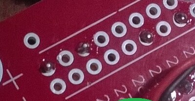

    0 mcb1 over 12 years ago in reply to Robert Peter Oakes
    Wallrug
    You may also need to pay attention for dry joints in the final part of this (after you add the base resistor)
    These suggest poor contact with the connector.

    0 D_Hersey over 12 years ago
    Those joints do not look very good.  In future, you should rub the stuff you seek to solder with a pen eraser, being sure to rid yourself of any shavings.  Sometimes, oxides are invisible, but  still present.  The solder pattern suggests that the solder has more adhesion for itself than the matter at hand.  The meniscus is curving the wrong way.  Since about 1980, the atmosphere has much more SOx  and NOx in it, from, you guessed it, cars.  Since then I have been spooning on a little flux with a toothpick to do these jobs, in addition to the abrasion.  I ordinarily use MG Chemicals Rosin Flux.  I have more aggressive stuff in the freezer.  I have some Soviet stuff that smells so good, it is hard to resist using.  Dwelling just a little longer with a wettish tip would probably help.  If you find yourself pumping in rosin-core solder, then wicking it off, you are after the flux, not the solder.  Get some flux.

    0 Problemchild over 12 years ago in reply to wallarug
    Sorry there I don't to Labour it but really  you need to check over that soldering and clean up all those joins  several have far too much solder and several barely any at all and this may just be the problem any number of bad joints would cause your problem
