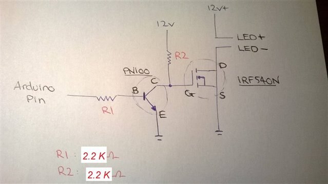

I have come up with this circuit (below) using a couple of NPN transistors and two power supplies.  In the diagram below, I am aware that the transistor pinouts are EBC.  The ones I am going to buy have a pinout of BCE.
The only problem with this is that I have very little understanding of transistor circuits.  What this circuit has to be able to do is:
  • Using the smallest amount of current from the Arduino (at 5 volts) or a Raspberry Pi (3v3 volts), turn on the circuit to allow the 12 volts that powers the LED strip lighting to flow.
I was thinking of using either TIP41C NPN Transistors (in a darlington Array) or TIP122 NPN transistors.

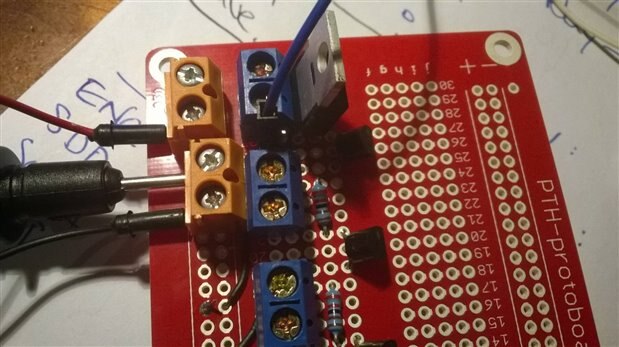

    I have built one sample circuit on the PCB but I have an issue.
    When the wire coming from the Arduino (pin 9) registers 4.95v when it is NOT connected to the board.  When that same wire is connected to my circuit board, it registers 0.9v (from pin 9).
    Any ideas what is causing this?  When I built the exact (when I say exact I mean EXACTLY THE SAME) same circuit on the breadboard it works perfectly.
    I am missing something?

    Can we presume that you have made the cct based on this
    okay ...seriously you need to add a resistor between the Arduino pin and the PN100.
    The 0.93 v you are measuring is because the Arduino is trying its hardest to ram 5v down the base junction of the PN100.
    Luckily the Aduino will limit the current to 40mA ...so at least it isn't destroyed.
    Once you've done that you might find your PN100 starts behaving properly.

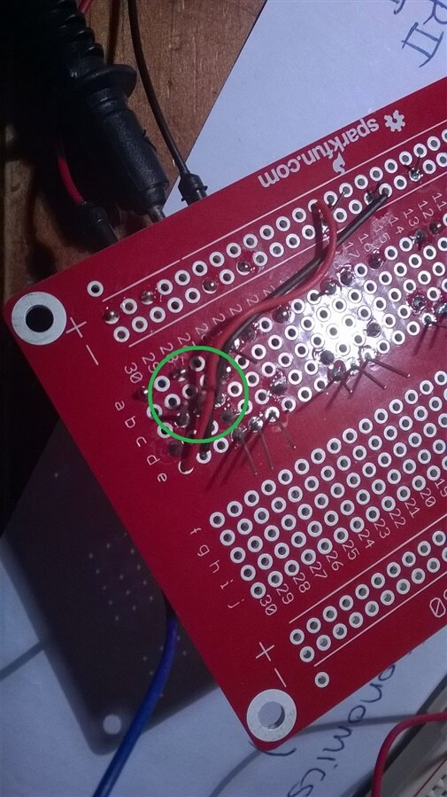

    Just to clarify this is what I have:
    Working (breadboard):
    Not working (referred to as: PCB):
    Underside:
    Green Circle is where FET comes out.
    Testing conducted on PCB:
    1. voltage from Arduino to NPN base: 0.9v
    2. voltage from resistor: 4.95v (1) - 0v (0)
    3. voltage out of going into FET gate: 4.95v (1) - 0v (0)
    4. voltage out of FET Drain: 0.02v (0) - 0v (1)
    Any ideas?
