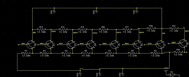

Hello it is me Noah again as you may remember me from my last post I am trying to build an arduino rocket controller and I am at prototyping stage. First of all you should know that I am using transistors BD712 which a pnp transistor that I need to amplify a current. The reason I need it to amplify a current is because I need it to increase 5V to 7.5V and to then send the current to my fixed barrier terminal blocks where it will then detonate the rocket motors. You see first of all in order you need a base resistor that connects to ground. The reason you need that is to prevent the board from short circuiting. I have placed several base resistors at several points and according to wikipedia I think I am doing this right. It says on wikipedia that I should do this.
NPN_common_emitter.svg
And this is what I did.
Please can you help me because I am not even sure what a transistor is?
    Look up Voltage Regulators -> Boost Regulator. I think this is the best solution for you, although it doesn't answer your question...

    0 nschreiber0813 over 12 years ago in reply to michaelwylie
    Dear: Mike
    Could a voltage regulator amplify a current or does it not do that?

    1. Start with figuring out how much current your load will need and at what voltage (power). Then try linear technologies and look for a regulator that can deliver that output voltage at the rated current.
    2. How much current are we talking about?

    I am talking about voltage being in between 7.5V and 9V. Could a regulator do that.

    The regulator will take an input voltage and transform it to a new level. You can increase the voltage, or decrease based upon an input voltage. A 7909 regulator can deliver 9 volts at 1 AMP. The output voltage will always be 9 Volts as long as the input never drops below a threshold value. This is a typical linear regulator (old technology). You can also increase voltages using boost regulators.

    No problem. Since you are new, as you mentioned, always keep in mind when you are regulating or amplifying that devices have power limits. If you exceed these power limits the device will ... well... be destroyed, usually violently. Think of a loud popping sound and a puff of smoke. Just keep this in mind as you design; I only mention it because I've destroyed more than my share of components.

    Oh, I almost forgot, you initial design with transistors was going in the right direction. Look up linear regulator and you'll see how these things are implemented inside the chip.

    It would be useful to know how much current you would need to actuate an ignitior, and if they melt open when actuated.  If this is the case, you could use a thrystor.
    In the more general case of having to actuate a solenoid in the Ampere regime,  usually the best thing to do is not to use a transistor, but rather to trick a linear voltage regulator into becoming a switch.  This way you get the advantage of its thermal and overload protection, which would be a PITA to implement with discretes.
