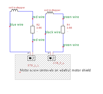

    0 e14 Contributor over 11 years ago
    I have tried to make a schematic:
    The gray area represents the adafruit motor shield.

    0 e14 Contributor over 11 years ago in reply to clem57
    Hi Clem.
    The Idea is to decrease the voltage.
    My idea is, using calculations, that if:
    3.125 V = 2.5 A * 1.25 Ω
    Which gives the voltage of the stepper.
    My consideration is if I put a 3.55 resistor in serie, as in the schematic in a former post, will this resistor obtain the excess voltage?
    By calculation:
    12 V = 2.5 A * (1.25Ω + 3.55Ω)
    where the 3.55Ω resistor is the one I'm talking about.
    Is it possible to do it that way?
    Or will the resistor consume too much energy?
    Perhaps it's better to crate a voltage divider to reduce the voltage?

  • Robert Peter Oakes
    0 Robert Peter Oakes over 11 years ago in reply to clem57
    In most stepper motor controllers (Modern ones), you do not limit the voltage by setting up a divider (R1, R2 ) as they manage the pulse width in the same way as driving an LED with PWM, it is more about the current going through the Motor, its inductance will limit this automatically and is often set-up in the configuration of the controller
    So having a motor with only 1.25Ohms DC resistance means nothing to a pulse, its inductive reactance is what will matter and that to a pulse can be much higher than the DC Ohms
    It would be common to see a stepper like this having say a 12V supply but still driven directly from the controller with no additional limiting resistors, you can often have a current sense resistor that provides feedback to the controller so it can manage the average current / power through the motor
    • Reject Answer
    0 Robert Peter Oakes over 11 years ago in reply to e14 Contributor
    See my other coment but in context to your comment, most motors have a rated current, not voltage and the controller takes care of the difference
