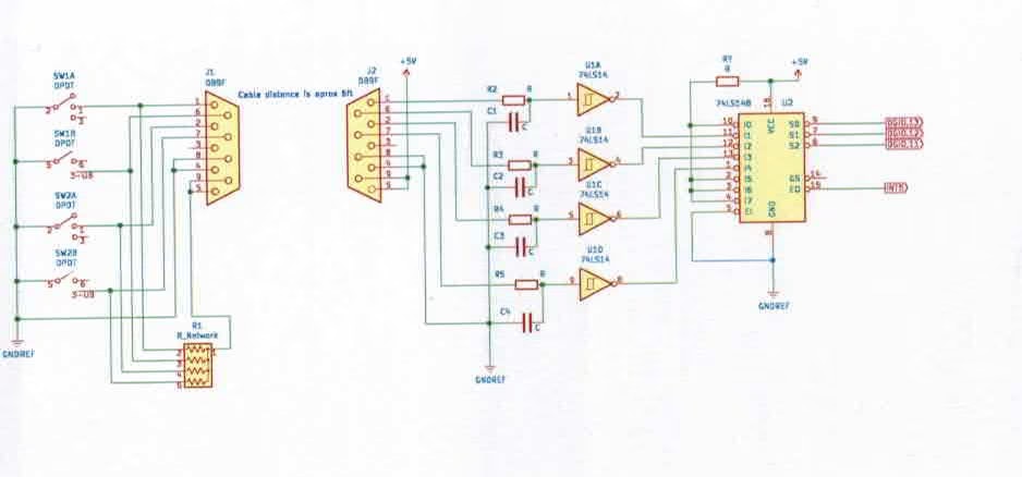

     colporteur Hi, personally   I do not like soft debounce. I much prefer to get it over with a Schmitt Trigger (IC) you can use CD40106 (CMOS) or my favorite SN7414N, it is ubiquitous, and has many families.  you can look here for how it's done.  there is more info on this page:  if you wish to see the full article there is linked under one of the photos. This works ALL THE TIME, rain, snow whatever.. LOL
  • mayermakes
    mayermakes over 2 years ago
    in some cases a simple RC-network on the button does sufficient debounce, would be cheap and quick to try out.
    i usually use a 0,1uF cap and 10k resistor.
    shabaz over 2 years ago in reply to phoenixcomm
    Agree..
    The software debounce is now just moving the problem, especially because of the comment "controlled by a button some distance away from the Arduino Mega. The 26 gauge copper pair acts like an antenna for picking up noise".
    Now if a software debounce library is used, the question becomes, what sort of debounce to do in software? The debounce library can be configured with about 3 options, and not all will work if the issue is noise pickup (which is unrelated to button debounce).
    At some point, the issue needs to be understood, for the best configuration of code, regardless of whether a library is used or not. I too would have gone with hardware fix, although to augment the software debounce, i.e. an approach that uses both software and hardware.
    Also, one really needs to look at the code, and learn how the debounce works, and where and why it is needed, otherwise one will never move forward at learning how to marry up code to the underlying problem or task at hand,
    I sketched this, just as a discrete version. It can tolerate a lot of noise. The resistors could be about 2.2k ohm, for the collector one, and the base-to-emitter one could've 2.2k ohm too. Maybe 10 k ohm for the resistor connected to the switch. And a capacitor will help, maybe 100nF. This would all cost just $0.20 perhaps.
    And for the logic IC version, I'd do the same as phoenixcomm recommends. A resistor can be added to prevent the input floating. This circuit expects the switch to be connected between positive supply and the Schmitt trigger input, but it could be rearranged if it's preferred to have the switch to ground.
