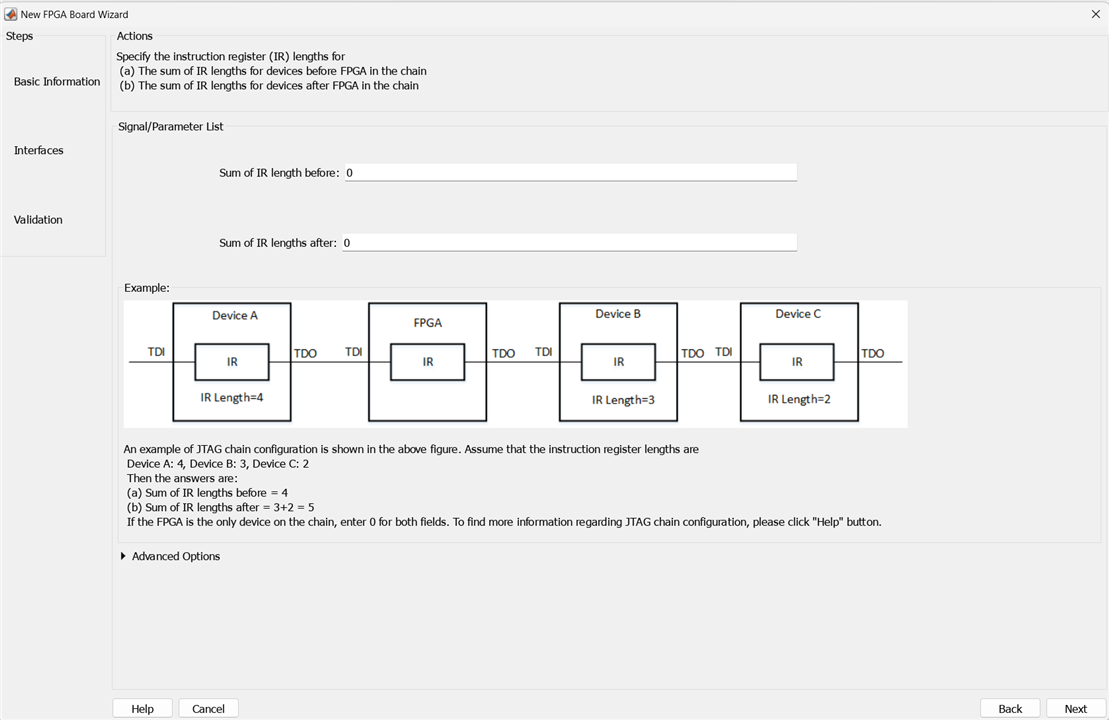

My project requires control of an AUBoard-15 from Matlab (using the Matlab generated JTAG to AXI block). To that end I am required to create a Board definition file using the interface provided in Matlab. Can someone help me with the entries requested below. I do not have access to the schematics. I am not sure how to go about coming up with answers to these questions.

    There are only two options for JTAG on the AUBoard - the FPGA and the FMC connector. If you are not using the FMC connector, then the FPGA is the only device in the chain. As far as IR length of the FPGA…

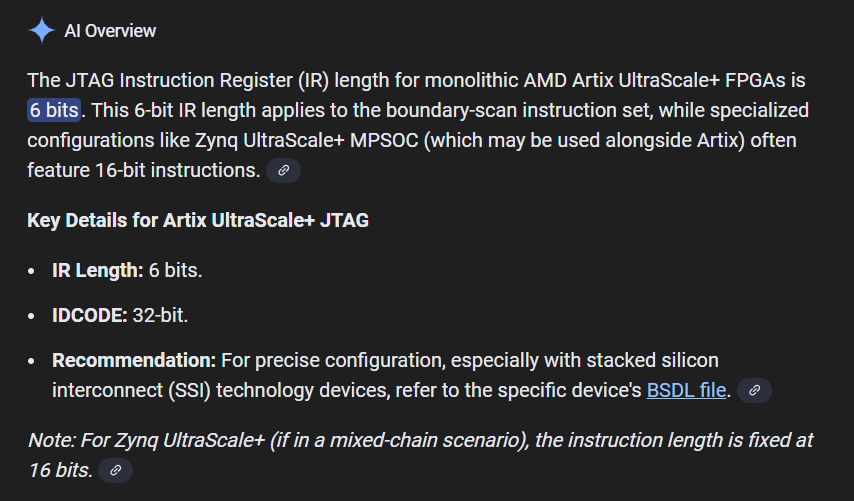

    Take this for what it is worth from AI:

    There are only two options for JTAG on the AUBoard - the FPGA and the FMC connector. If you are not using the FMC connector, then the FPGA is the only device in the chain. As far as IR length of the FPGA, you more than likely need to dig into some datasheets for the Artix UltraScale+ and if you are using an FMC card, you will need to determine what devices on that card are in the JTAG chain and similarly find their IR length.
