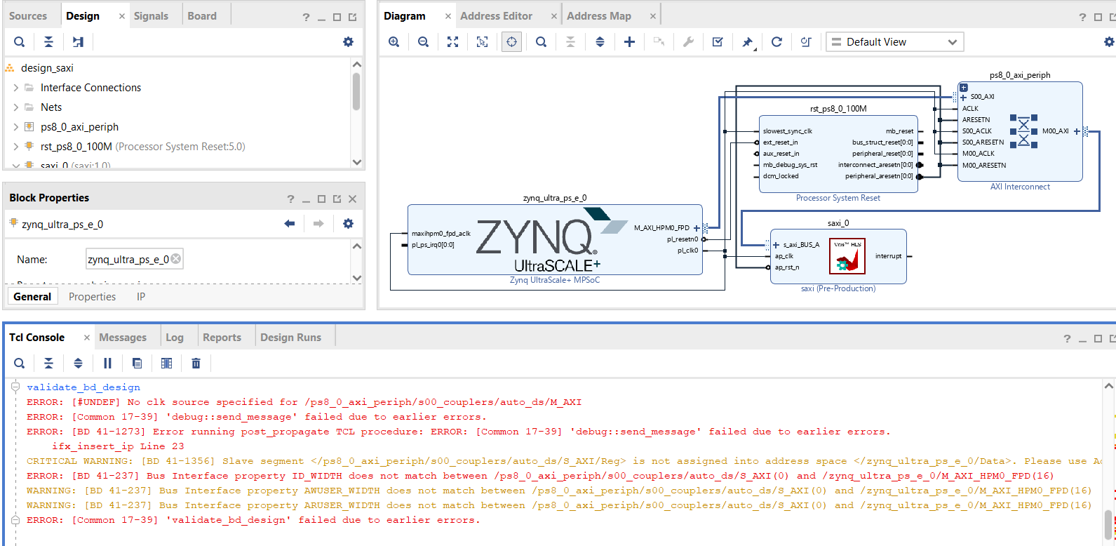

    Hi,

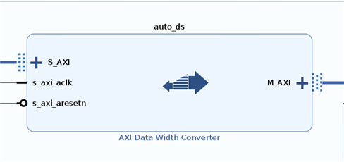

    I am doing the same thing, where I want the PL to perform some action based on the data from the PS and send the data back to the PS.Also, when I connect the PL to the PS, i get the following errors.
    1. ERROR: [#UNDEF] No clk source specified for /ps8_0_axi_periph/s00_couplers/auto_ds/M_AXI, when I try to connect the PS clock to it I get net interface errors.
    2. ERROR: [BD 41-237] Bus Interface property ID_WIDTH does not match between /ps8_0_axi_periph/s00_couplers/auto_ds/S_AXI(0) and /zynq_ultra_ps_e_0/M_AXI_HPM0_FPD(16)
    The ID width of both of these are read only hence I can never change them.
    I will also attach the image , Please let me know if any changes can be made.

    Hi Praseetha,
    I don't see the image you say you attached, so I can't comment on the correctness of your block design.
    Are you also targeting the UltraZed SOM mated to the I/O carrier?  If so, you might want to use a known-good design as an example to examine the AXI interconnect and clock connections, etc.  You can use the instructions in this Avnet HDL git HOWTO (Vivado 2020.1 and earlier)  blog to build a known-good Vivado hw platform for Avnet SOMs and SBCs.  This blog admittedly needs to be updated for recent changes we have made on the 2020.2 branch of the git repository, but in general the instructions should still get you what you need.
    --Tom

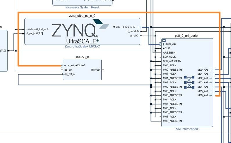

    0 praseetha over 5 years ago in reply to narrucmot
    Hi Tom,
    No I am trying to connect a PL that I created on Vitis HLS, to the zynq ultra scale MPSOC. When I add both of them and simply click run automation , I get the following errors.

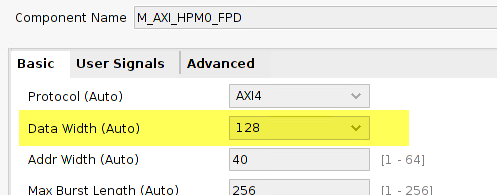

  • drozwood90
    0 drozwood90 over 5 years ago in reply to praseetha
    Hi there,
    As Tom mentioned, you probably want to take a look at how we set things up.  There are a LOT of configurations that you need to setup and as I suggested to the original user, if you are not familiar with AXI or working at that level of hardware, Vitis might be better for you.  It handles all the interconnect and data movers for you.  The simplicity is you only need to add in XLCONCAT blocks for interrupt feedback to the PS and "Processor System Reset" blocks.  From there, define the resources the tool is allowed to use and hit go.  You can grab our code from the Avnet repos and download that.  Run the make scripting and you will be able to see all the pieces that we put into place.  A shortcut can be taken if you look at the following link, where you can see what we do to "add" Vitis/SDSoC capabilities:
    https://github.com/Avnet/hdl/blob/2020.2/boards/u96v2_sbc/base/u96v2_sbc_base.tcl#L546
    http://github.com/avnet/[repo]
    where [repo] is all 4: bdf, hdl, petalinux, vitis
    Make sure you use the correct tag/branch!  Also note that as of this post the 2020.2 branch is not stable.
    All that being said, I am not aware of the exact details of HLS's needs, as we use Vitis to avoid this very problem.  HLS's needs can be VERY custom depending on what you are specifically doing.
    Have you been through the HLS user guide?
    https://www.xilinx.com/support/documentation/sw_manuals/xilinx2020_2/ug1399-vitis-hls.pdf
    Maybe that can help you?
    For your second error, you have a bus width mismatch.  The AXI is defined to be 1 size and everything MUST comply.  If you do not have a bus that is of the same width it will not bolt up properly.
    Think of the issues connecting bus(0 upto 127) and connecting it to a bus2(0 upto 15) or even bus3(15 downto 0), they will mismatch.  You would need to adapt to the hardened AXI as the multiples of it's configuration do not change.  In the case of AXI, you would need to use AXI Data Width Converters.
    More details of your particular AXI needs can be found in the datasheet for the IP.  Double click the IP, then click on the Documentation button in the upper left of the Re-customize IP menu.
    I cannot locate the documentation, but I think it is multiples of 32, and here is an example of what we have setup for Ultra96V2.  Here is a screen capture of the M_AXI_HPM0_FPD for the Ultra96V2 design:
    ALL of even THAT being said...if you are not familiar with this flow, I believe it would really help to just use Vitis.  It's ability to handle all that interconnect is really it's power and in the time it took to reply to this, you might have already been up and running!  Once you have your platform setup, it really is that fast.  I've done demonstrations where I retargeted solutions to all of our platforms as fast as I could click the mouse.  The tools take care of creating/linking/setting up all of the data movers.
    Hope that helps you out!

  • praseetha
    0 praseetha over 5 years ago in reply to drozwood90
    Hi Daniel,
    Firstly Thank You so much for explaining all of this.
    The board that I am using is https://www.xilinx.com/products/boards-and-kits/zcu104.html.
    I have used Vitis HLS to configure the saxi_0 IP:
    Code
    #include <stdio.h>
    void saxi(char a, char b, char c)
    #pragma HLS INTERFACE s_axilite port=a bundle=BUS_A
    #pragma HLS INTERFACE s_axilite port=b bundle=BUS_A
    #pragma HLS INTERFACE s_axilite port=c bundle=BUS_A
    #pragma HLS INTERFACE s_axilite port=return bundle=BUS_A
    c += a + b;
    return ;
    #include <stdio.h>
    void saxi(char a, char b, char c);
    int main()
      char a;
      char b;
      char c;
      char d;
      char sw_result;
      printf("HLS AXI-Lite Example\n");
      printf("Function c += a + b\n");
      printf("Initial values a = 5, b = 10, c = 0\n");
      a = 5;
      b = 10;
      c = 0;
      d = 0;
      saxi(a,b,c);
      d += a + b;
      printf("HW result = %d\n",c);
      printf("SW result = %d\n",d);
      if(d == c){
        printf("Success SW and HW results match\n");
        return 0;
      else{
        printf("ERROR SW and HW results mismatch\n");
        return 1;
    This is not my actual project but I am trying to configure the connection on something small first before I do the connections for my code.
    1. If I understand you correctly, You are telling me to write a code for all the connections is that correct ? including the PS , DRAM, and everything can be written on vitis HLS?
    My initial plan was to create PL on vitis HLS and configure it with the PS on vivado.
    2. If I can write the entire connection on vitis HLS as per the github link you have provided, can this be used for a zynq board as well ? Or do you have the code for this board
    3. I need to design a system where the input data comes from the PS, the PL does the computation and the result is transferred back to the PS. Can all of this be written on vitis HLS?
    As of now I have a working IP, which performs the intended task on PL. (again this is a code explaining my pragma directives that i have used but not my intended task)
    Thank You for your support!
