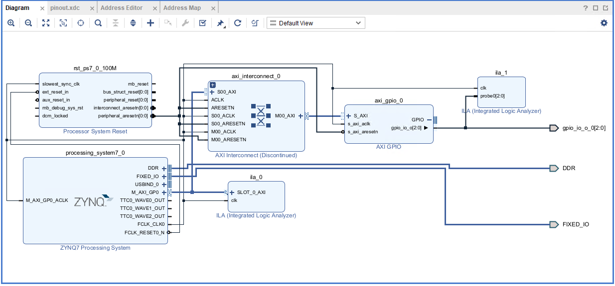

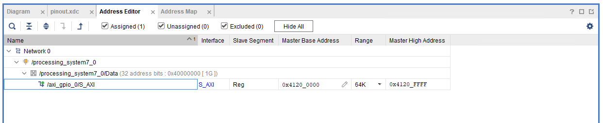

    Can you post a picture of your BLOCK DESIGN and ADDRESS MAPPING from Vivado?

    I also tried to "Make External" the GPIO from AXI GPIO (without ILA).
    Same results.....

    Everything looks in order from Vivado standpoint. What about your Petalinux setup?
