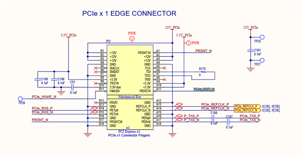

I look at the schematics and it appears that the PCIe_REFCLK is an output of the edge connector?
Does that mean the PCIe_REFCLK is an input reference clock the GT Transceveiver inside of the FPGA?

Is PCIe_RST_N generated by the FPGA in the case of the root complex mode?  or is it alway an input regardless of root complex or end-point mode. When I look at schematic it show it as an output to the edge connector which would seem to indicate that I always generate PCIE_RST_N.  is this correct?

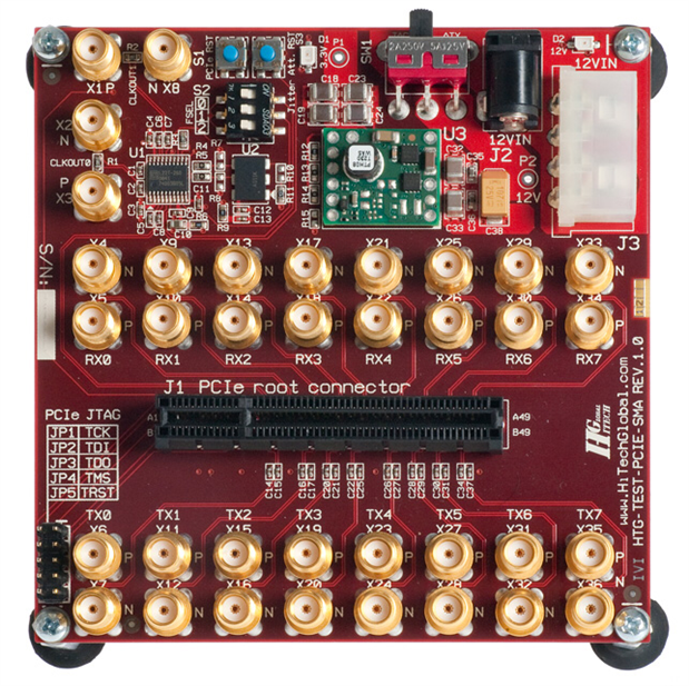

    This seems to do the job for generating root complex reference clock:
    PCI Express Gen1/2/3 Test & SMA Breakout Board from hi tech global
    http://www.hitechglobal.com/Accessories/PCIExpress_Test_Board.htm

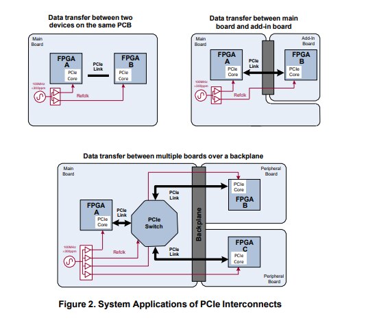

    For instance, this document implies that pcie clock can be sourced from any board in the system as long as both sides agree:
    https://www.silabs.com/documents/public/white-papers/PCIe-Clock-Source-Selection.pdf
    But I haven't had too much luck getting the ZYNQ FPGA to source a PCIe differential clock and also drive the Vivado PCIe core at the same time.

    • PCIe_REFCLK comes in on the card edge.  Trace the signal in the schematic and you will see that it is an input to the IDT (now Renesas) clock, the clock comes IN on the card edge, like any other endpoint device
    • Yes, it is an input to the FemtoClock, and then passes to the MGT after it is cleaned up

    • The PCIe_RST_N would need to be generated by the root complex in the case of the 7030 being the root device.
    That board you selected can break things out and generate your clock.  I have used that as loopback testing and can say it works well.  You will need a way to convert the data and clocks back to your edge device you plan to connect to, but SI problems aside, it will allow you to break out this device.
    In the case of the PicoZed FMCv2, the board cannot source the clock.  It is not wired like that.  The V1 could do that, but this one cannot.  It was setup as an endpoint device.  Regardless, the Zynq device should not be sourcing the clock.  It cannot output a high enough quality clock.  That is why you would use a device like the FemToClock or the adapter board you linked to, which would be able to source such a clock.
    Long story short, if you use that breakout card, you can use IT to insert the clock into the PicoZed, setup the PicoZed as a root, then you need to send that adapter board's clock over to the endpoint device, along with the data lines.

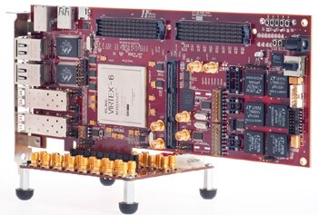

    maybe a better choice... can configure one card a endpoint and other card as root complex device and connect this with this card that had PCIe clockdevice

    From the screen shot, I do not see how this will connect beyond the single card input.  Maybe I am missing something from the picture?
    You need a board that has a root connector.  You will need to be concerned about the SI as well.  So watch for that.  The PCIe protocol is pretty robust, but you want to be sensitive to the SI so you do not burden it and lose performance.
    With the hightechglobal solution, you could just get two boards (which is what I thought you were doing).  One runs as the root and the other as the endpoint.  Then you wire them together using properly rated COAX.  Using only 1 board as a clock source (the one setup as root).
