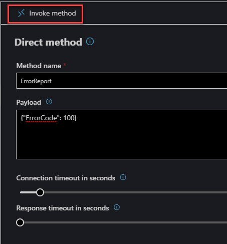

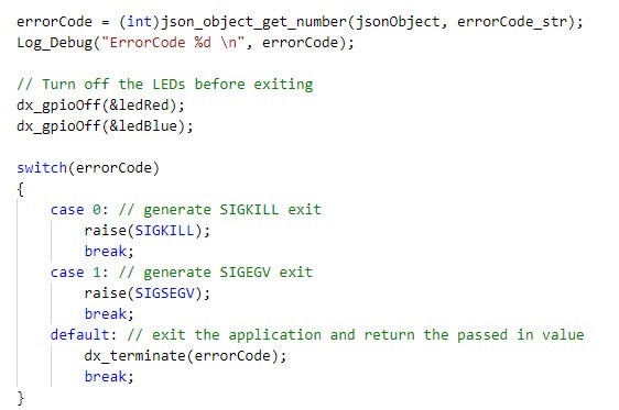

Direct Method details
     Expected payload: {"ErrorCode": <integer>}

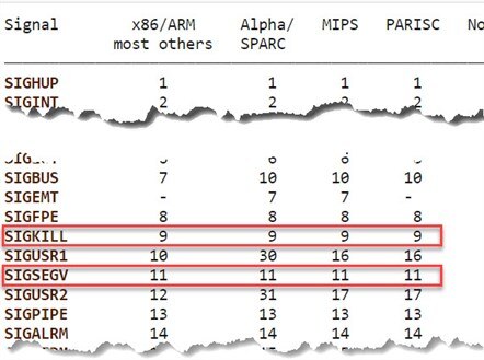

     ErrorCode == 0, the application exits with the SIGKILL signal
     ErrorCode == 1, the application exits with the SIGEGV signal
     ErrorCode > 1, the application exits and returns the passed in ErrorCode value to the OS
The direct method code is straight forward.  First turn off both the red and blue LEDs, then use the passed in payload in the switch statement.

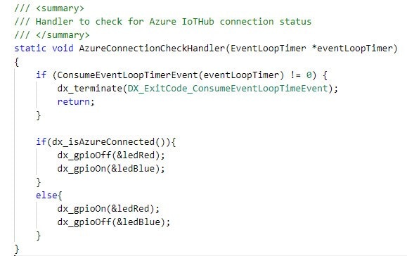

IoTHub Connection Status LED
Since my application will be exiting or crashing, and I want to run a few different tests, I added code to drive the Avnet Starter Kit RGB LED based on the connection status.  This way after I crash the application, I just need to wait for the Blue LED to run my next test.  Note that the Azure Sphere OS monitors the status of the application and will automatically restart the application if/when it exits for any reason.
     RED == Not connected to the IoTHub
     BLUE == Connected to the IoTHub
The LED logic runs every 2 seconds

  5. Using the AzureIoTExplorer tool
    1. Call my direct method with payload {"ErrorCode": 100} // Application exits and returns errorCode 100 to the OS.  Why 100?  Avnet turned 100 years old in 2021!
    2. Wait for the application to restart and connect to my IoTHub
    3. Call my direct method with payload {"ErrorCode": 0} // Application exits with the SIGKILL signal
    4. Wait for the application to restart and connect to my IoTHub
    5. Call my direct method with payload {"ErrorCode": 1} // Application exits with the SIGEGV signal

Exercise the direct method
Next we need to crash the application using the direct method.  I'm a big fan of the AzureIoTExplorer tool.  I'll use this tool to call my direct method from the cloud.
  • Pass in errorCode 100 to the direct method.  When the application processes the direct method call, it exits and returns 100 to the OS as the exit code.
  • Call the direct method again with payload: {"ErrorCode": 0}  // generate a SIGKILL event like you ran out of memory!
  • Call the direct method again with payload: {"ErrorCode": 1} // generate a SIGSEGV event

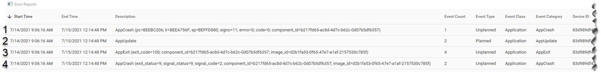

Pull and review the error logs from my Azure Sphere tenant
You can use the Azure Sphere CLI or the Azure Sphere Public API to pull the error logs.  When I ran my experiment my error logs did not show up in my error report until the next day.  Since error reports are only sent to the Azure Sphere tenant once a day, this makes sense.
Follow this link to see the details for downloading the error report using the Azure Sphere CLI.  Here's an example of the CLI call
> azsphere tenant download-error-report --destination c:\error-report.csv
I'll be using a tool called Azure Sphere Explorer, this is a new tool that I recently learned about.  It's pretty basic, but it uses the Azure Sphere Public API to expose details about your Azure Sphere tenant including pulling the error report.  After running the tool and requesting my error report, I can see my events.  Please click on the image to enlarge it.
If we decode each of these events . . .
  1. This event was an application crash.  The signal is reported as 11 (SIGSEGV).  The program counter, stack pointer and component_id are all included in the reported.  The signal enumerations can be decoded by referencing the signal man page.  See the graphic below from the man page.
  2. This event was an application update and it happened two times.  Once for the first deployment and after I used my example application for the first time I decided to add the LED feature.  I loaded the new application to my OTA deployment and this event was captured as a second planned application update.
  3. This event was a result of the application exiting and returning exit code 100.  Looks like I exercised this 4 times!  Note that the report includes not only the exit code the application returned, but also the component_id (from the app_manifest.json file that identifies my application) and the unique image_id from the OTA deployment.  Using this information, support teams should be able to identify the specific build that was running and the exact line of code that encountered the unexpected condition (assuming the error code is only used from a single location in the application).
  4. The last event is a application crash with SIGKILL signal.  Again the component_id and image_id for the application are captured.
