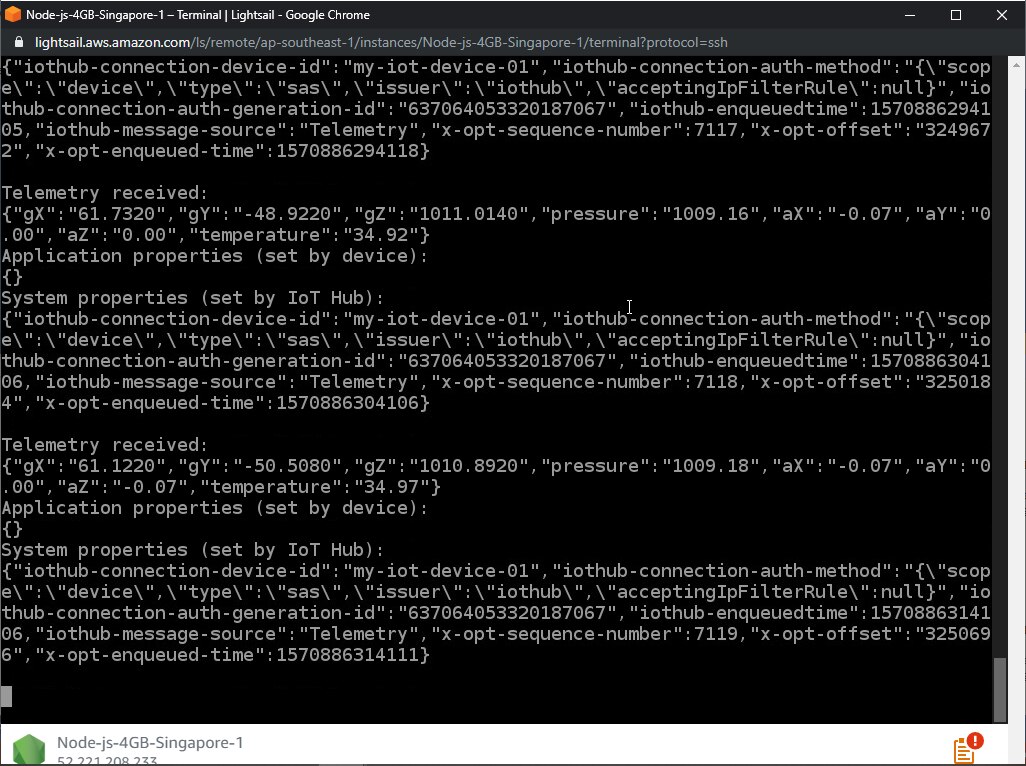

Lately there is a haze hazard happening in Malaysia. I thought of doing the air quality project using the Azure Sphere MT3620 Starter Kit.  While researching on doing the project, I found out that I do not have the air quality sensor to use with the Azure Sphere.  Hence I change it to this project which I use the onboard temperature sensor and a relay click board.
Features
The idea is simple.  The context is my home where I want to keep it comfortable whenever it is too hot or cold, especially at night.  This is important if you have elderly persons and kids at home.  The project uses the onboard temperature sensor to monitor the temperature and sends the telemetries to Azure IoT Hub.  Using Azure Function, a simple app will be triggered when telemetries arrive and send a command to turn on an air-conditioner or fan in my home.
Basically the project showcases a working configuration between Azure Sphere and IoT Hub with device twins.

ReadDeviceToCloudMessagesUpdateTwins.js
This code will read and print the messages from a Azure IoT Hub and turn on the relay click when the onboard temperature is above 33.8 degree Celcius.  This is accomplished thru updating the device twins at IoT Hub.

Demo
Here is a picture of hardware setup.  The onboard temperature sensor and a relay click are used in this project.
Here is the video.  When the temperature of the onboard temperature sensor is above 33.8 degree Celcius, it wil turn on the relay click.  Refer to the code above for details.
