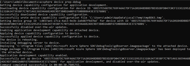

Section 2: Now you can run your first application on your device in debug mode.
2.1. Put your device in debug mode:
azsphere device prep-debug

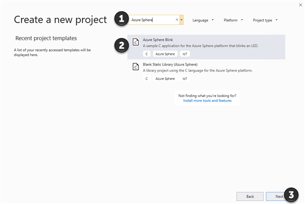

2.2. Open Visual Studio:
2.3. Create New Project:
