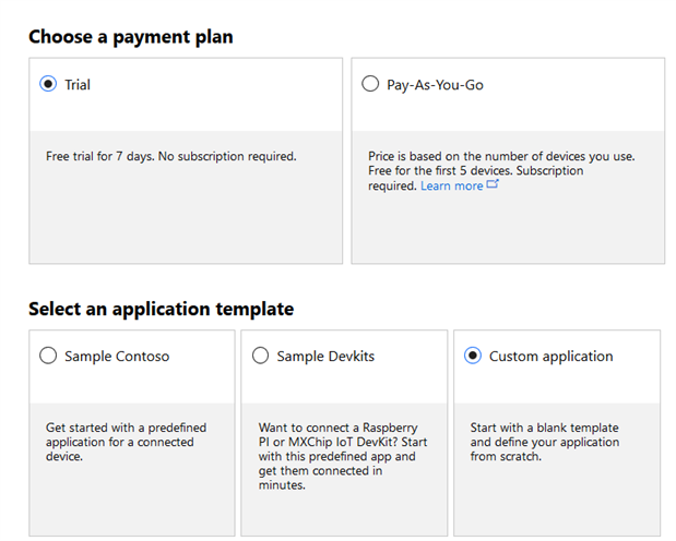

Section 3: Create an Azure IoT Central Application.
3.1. Go to the site and log in using your Azure Active Directory Credentials: https://apps.azureiotcentral.com/create

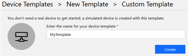

3.2. Create application:

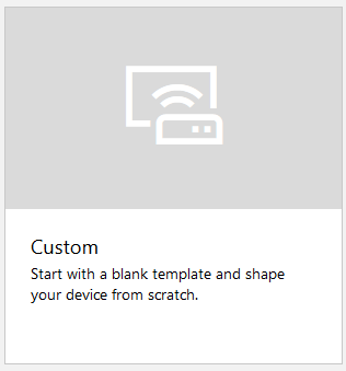

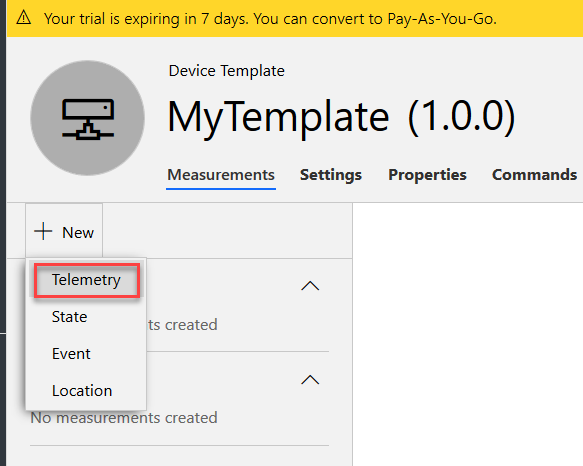

3.3. Create a Device Template:

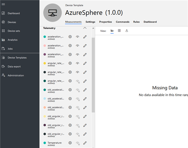

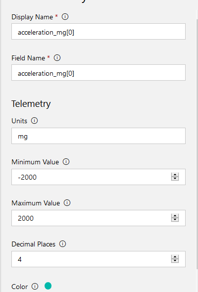

3.4. Add the following telemetries:
You have to add each of the following as a separate telemetry entry:
acceleration_mg[0]
acceleration_mg[1]
acceleration_mg[2]
angular_rate_dps[0]
angular_rate_dps[1]
angular_rate_dps[2]
old_acceleration_mg[0]
old_acceleration_mg[1]
old_acceleration_mg[2]
old_angular_rate_dps[0]
old_angular_rate_dps[1]
old_angular_rate_dps[2]
Enter them like this:
After entering each telemetry entry you should have the following:

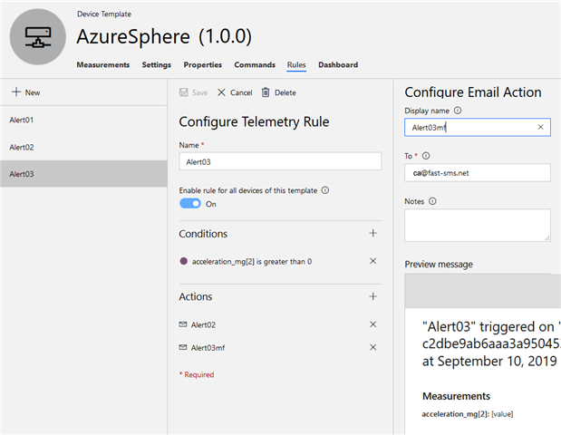

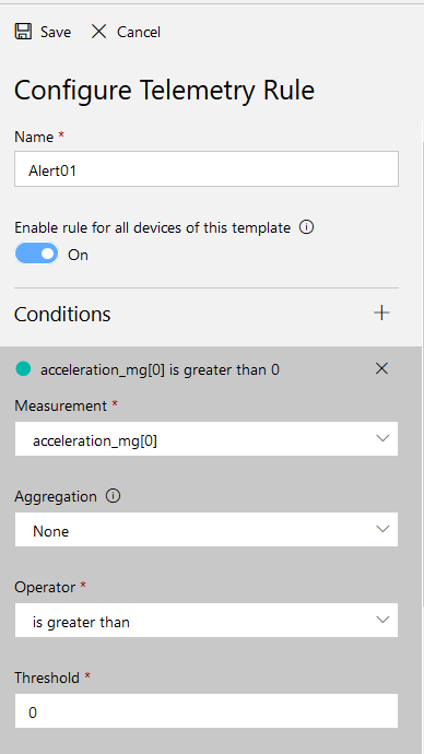

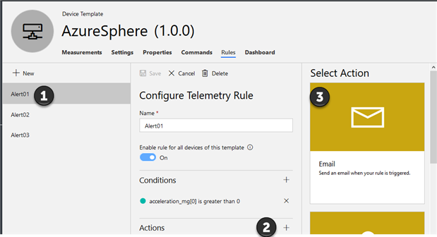

3.5. To configure email message after detecting Vibrations on the device go to the Rules and Click New/Telemetry:
3.6. Name Rule and add a condition like here:

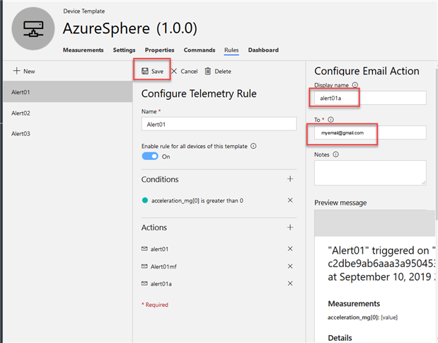

3.7. Save it and Open and choose Email:
3.8. Configure email Action and Save:
Change the email address to wherever you want the warning messages go.
3.9. Do the same for:
acceleration_mg[0]
acceleration_mg[1]
acceleration_mg[2]
You can add more than one email action like here:

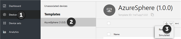

3.10. Add your Real device and delete any existing simulated one:

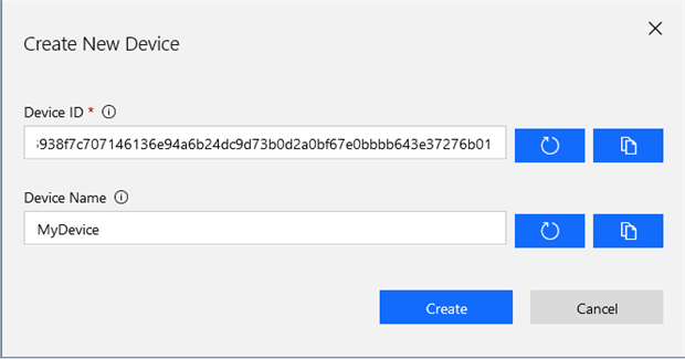

3.11. Device id can be acquired this command (it must be a lower letter):
powershell -Command ((azsphere device show-attached)[0] -split ': ')[1].ToLower()
