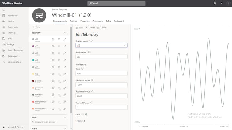

Parameters configuration at Azure IoT Central, Under Device Template, configure below as shown in the image.

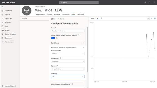

Alert Configuration
Under Rules add telemetry rule as described below, which will trigger the rule when rotation sped goes beyond 25 rotation per minute for a period of 5 minutes, then save and click on the action, select the email and provide the email address as described below.

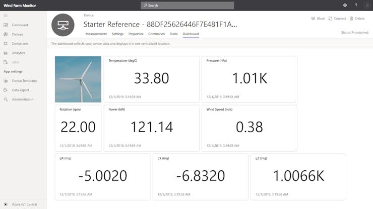

Now Dashboard is ready to display details as below
