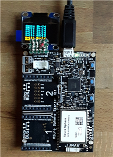

My issue is actually solved!
I waA trying to upload a new image to my device but get:
Copying application to the device
Device would not stage app for sideload: Image not trusted by device; application development capability is required ('azsphere.exe device prep-debug') (DeviceClientException)
The problem is that my device seems to be waiting an update. I pressed reset several times, the wifi is enabled and connected but OTA doesn't start.
No news about version 19.07 in aka.ms/AzureSphereUpgradeGuidance
C:\Users\EAC\Documents>azsphere device show-ota-status
Your device is running Azure Sphere OS version 19.06.
The Azure Sphere Security Service is targeting this device with Azure Sphere OS version 19.07.
warn: Your device is running an older Azure Sphere OS version (19.06). It has not yet started receiving the available update to version 19.07.
warn: Your device is connected to Wi-Fi. If the over-the-air update does not begin, reset your device and try again.
Go to aka.ms/AzureSphereUpgradeGuidance for further advice and support.
Command completed successfully in 00:00:03.9230754.
Well, my device has been updated while writing this!  image
Your device is running Azure Sphere OS version 19.07.
Your device has the expected version of the Azure Sphere OS: 19.07.
Command completed successfully in 00:00:04.0478440.

    Looks like you forgot to put your device into debug mode before sideloading, the error is the clue. Use this command: azsphere device prep-debug

    javagoza over 7 years ago in reply to s2000gt +1
    Thanks, Mark, But this is not the solution I prepared my device with prep-debug before trying to upload the image but it seems that when waiting for an OTA OS update you can't upload a new image. Only…
    Thanks, Mark,
    Only resetting and waiting solved the issue. Patience is the only solution!
    Our devices are included in a Device Group for OTA update configuration
    C:\Users\EAC\Documents>azsphere device show-ota-config
    Retrieved the over-the-air update configuration for device with ID 'XXXXXXXXXXXXXXXXXXXXXXX':
     --> Device group: 'System Software Only' with ID 'cd037ae5-27ca-4a13-9e3b-2a9d87f9d7bd'
     --> SKU: '0d24af68-c1e6-4d60-ac82-8ba92e09f7e9' of type 'Chip'
    Command completed successfully in 00:00:06.9399272.
    https://docs.microsoft.com/en-us/azure-sphere/deployment/set-up-evaluation-device-group
    To trigger OTA update in the next 10 minutes, press the Reset button on the device. To verify that the device has received the Retail Evaluation OS:
