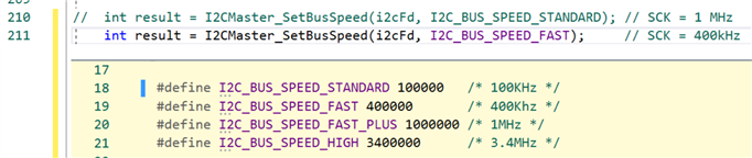

I thought that perhaps it was due to baud rate.  The Azure code shows 100000 for bus speed.  Example Arduino code for the device shows 115200 baud rate.  With the slave device powered down and still connected to SDA and SCL, it still caused the problem making me think its not baud rate.

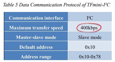

    Sean According to the TFmini I2C datasheet, the maximum rate for the I2C clock is 400 kbps. I recommend reducing the Azure Sphere I2C setting from 1MHz to 400 kbps to accommodate this. Change line 210…

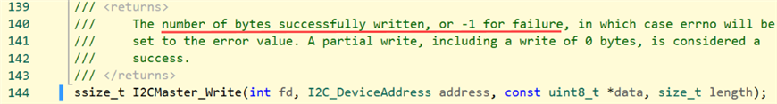

    Sean Two observations: 1) According to the definition of that I2CMaster_Write() function, this returns number of bytes successfully written, or -1 for failure 2) I'd suggest that your my_reset_value be…

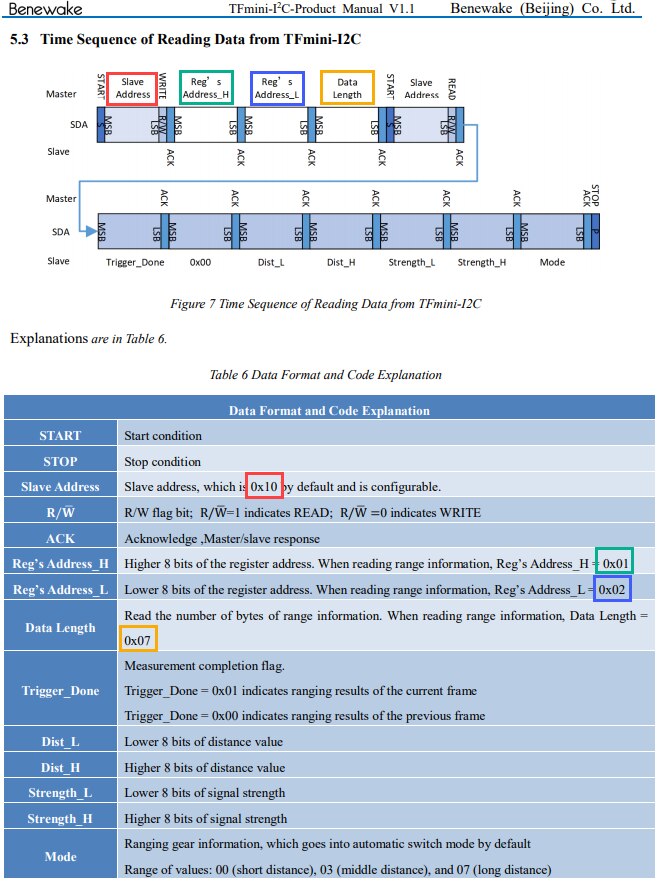

    Sean For that read data command you were originally trying to send, I'd recommend using the I2CMaster_WriteThenRead() command The format of this command is: ssize_t I2CMaster_WriteThenRead(int fd, I2C_DeviceAddress…

    Doh! You are too polite - I stand corrected, the default was 100 kHz not 1 Mhz
    It would be good to view this with a logic analyzer...

    Sean
    Two observations:
    2) I'd suggest that your my_reset_value be defined as follows:
    uint8_t my_reset_value[0] = { 0x06 };
    -Peter

    That's funny!    It was successfully writing the single byte all along.
    I copied the if statement from the line above and paid no attention.  Happens after this many hours of beating my head against the wall.
    ssize_t I2CMaster_WriteThenRead(int fd, I2C_DeviceAddress address, const uint8_t *writeData, size_t lenWriteData, uint8_t *readData, size_t lenReadData);
    and the values that you need to send are as shown in the datasheet:
  • Sean_Miller

    The MSFT documentation of that I2CMaster_WriteThenRead() library function is located here:
    https://docs.microsoft.com/en-us/azure-sphere/reference/applibs-reference/applibs-i2c/function-i2cmaster-writethenread
    Take a look at it's use also in the Weather Station Hackster.io project posted last week:
    https://www.hackster.io/gatoninja236/azure-sphere-weather-station-d5a2bc
    Good Luck - you are very close now! :-)
    -Peter
