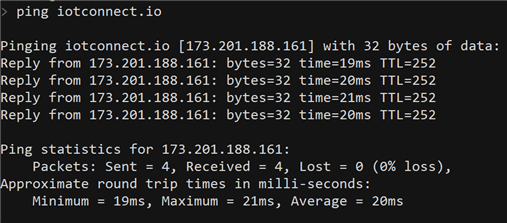

Just after I click Send to Server I receive:
URL response Fail!
{"cpId":"RkNGOTRGQjYtMUM5RS00M(              cut                 )","uniqueId":"hacksterSphere","data":{"emai(   cut            )}}
OK

    Solution - please add 13.77.82.141 avnetagent.iotconnect.io" to c:\Windows\System32\drivers\etc\hosts

    Mariusz
    1) Note that the computer on which you run the registration application must be connected to the internet!
    2) If PC internet connection is ok, then you may have a DNS issue. One user reported that avnetagent.iotconnect.io could not be resolved with CloudFlare DNS server.
    - Try access that avnetagent.iotconnect.io address directly from your browser, if this fails then DNS is the source of your problem.
    - See community discussion on this topic here:  https://www.hackster.io/contests/SecureEverything/discussion/posts/4999#challengeNav
    -Peter

  • frelfrel
    0 frelfrel over 7 years ago in reply to peterfenn
    avnetagent.iotconnect.io - can not be resolved....
    C:\Users\admin>ping avnetagent.iotconnect.io
    Ping request could not find host avnetagent.iotconnect.io. Please check the name and try again.
    Are you sure that it is a correct URL?
    I checked it from 2 diffrent internet connections!

  • peterfenn
    0 peterfenn over 7 years ago in reply to frelfrel
    Mariusz
    Thanks for your feedback. FYI, that avnetagent.iotconnect.io should be addressable from your browser, but the avnetagent cannot be pinged
    The domain however can be pinged from a command prompt

  • frelfrel
    But the problem is with name resolution, o you have to add it to host files.
