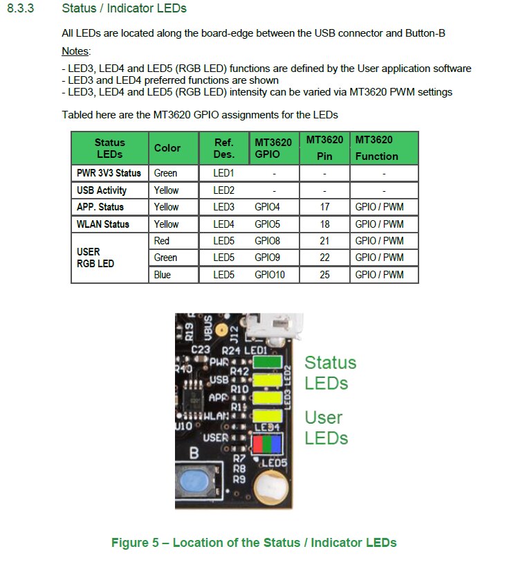

So i have been playing around with the Kit a little and i find it quite difficult to find any documentation whatsoever.
I pulled the GPIO sample application from
https://github.com/Azure/azure-sphere-samples/tree/master/Samples/GPIO/GPIO_RTApp_MT3620_BareMetal
Changing the GPIO pin from 8 to 9 or 10 drives the expected LED, however, changing this to pin 2 does nothing.
I assume it is on a different GPIO block but i am not sure and can't really find anything.
What am i missing here?

    What do you expect changing to GPIO 2? GPIO 2 isn't connected to anything in the kit. If you want to play with the leds: See the User Guide: Azure Sphere Starter Kit User Guide (v1.5) Azure Sphere - Tips…
    See the User Guide:
    Azure Sphere - Tips to max-out your Starter Kit hardware! (Part 1)

    I'd expect GPIO2_PWM, which is exposed on the pin headers, to output a TTL signal, which it doesn't.
    People with soldering irons and oscilloscopes exist.

    Sorry for the misunderstanding.
    As you had already pointed GPIO2 is in another block, so you have to add the block first, but I think that block base addresses are not public at this moment. Maybe you can try to figure which address is from this part of the code:
        // Block includes led1RedGpio, GPIO8.
        static const GpioBlock pwm2 = {
            .baseAddr = 0x38030000, .type = GpioBlock_PWM, .firstPin = 8, .pinCount = 4};
        Mt3620_Gpio_AddBlock(&pwm2);
        // Block includes buttonAGpio, GPIO12
        static const GpioBlock grp3 = {
            .baseAddr = 0x38040000, .type = GpioBlock_GRP, .firstPin = 12, .pinCount = 4};
        Mt3620_Gpio_AddBlock(&grp3);

    I also had the same problem, I'm using GPIO2 and GPIO1 in order to signal MRDY and SRDY in a SNP connection with a BLE TI cc2650SOMA module and I have had to make my driver in the high level app environment, until Mediatek frees some more info.
