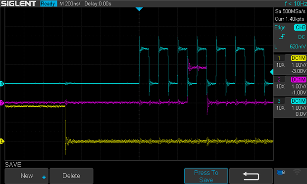

Scope Test
Next, I want to run a test that transmits some data so that I can see it on a scope.  For this, I'm going to use the xspi_polled_example, modified to suit my purposes.  Out of the box, this example performs a self test to make sure that the hardware is built correctly, then performs a loopback test.  I'm modifying it to perform the self test, delete the loopback test, then output some data to Slave 0 (as configured in hardware) 10 times.  Having built this and run it under debug I see the following:
Success.  The following images are what were captured on the scope:
{gallery} SPI Signals
Board Connections: a rather Heath-Robinson affair, but it seems to work.
Captured Signals: channel 1, yellow, is CS; channel 2, magenta is MOSI; channel 3, cyan, is SCK
Captured Signals: Dropped the CS channel, showing more of the data and clock signals.
Captured Signals: Showing even more of the data and clock signals.
This looks ok, a fair bit of ringing but I would expect that given the speed and the connection used.  At least it shows my idea of using GPIO pins to cross connect to the SPI pins on the Click Mezzanine has legs (or at least can crawl!)

    Ok....Trying different LCD initialisations, not conforming to the LCD driver chip on the LCD data sheet, but the Hitachi HD44780 which is the granddaddy of them all, I can actually see characters properly.  So it isn't a contrast issue, but an initialisation one.  I'm not sure exactly what the correct startup is yet as following that given in the Hitachi's data sheet leaves me with faint characters but missing out a step of the initialisation given there, leaves me with a readable display.  In any case, following the initialisation given by the LCD's data sheet leaves me with a misbehaving display.
    I can at least work it out from here!

    I want to make sure there isn't an issue with the initialisation of the LCD Driver because it doesn't make sense that this is unusable unless a change is made to the digipot which isn't actually addressable without bodging.
    Jan: the digipot can't be addressed, its CS pin is not connected to the Click Mezzanine header and not accessible.  Instead it's connected as an input to the Click Mezzanine's ADC input.  If you look at the two schematics I post above you will see that CS and CS1 are the CS pins for the two click board positions, and CS2 is for the ADC.  The only way to get to the digipot, whose CS pin is connected to the AN pin on the board, is by bodging a wire from the AN pin on the LCD Mini Click to a spare port on the Click Mezzanine header and then doing what you say but I don't want to go that far yet.
