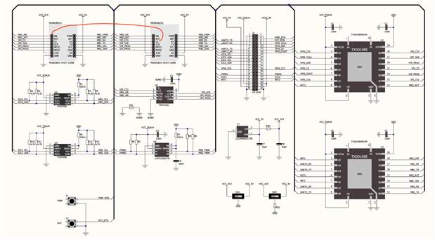

The LCD Mini Click has a digipot that, by default, powers up at midrange (actually, it is a non-volatile potentiometer so it powers up to its last setting.)  When the LCD operates in 2-line mode then the contrast is too low for the text to be visible at the default setting so the contrast must be adjusted.  This is accessed via the "AN" pin on the MikroBus (or, as labelled on the Click Board, CS2) and unfortunately that pin is allocated as an input to the ADC on the Click Mezzanine so there is no direct way of addressing the digipot.  A number of possible solutions were given in the comments on Post One of this series, but I've taken the approach of cross-wiring the CS pin on MikroBus 2 to the AN pin on MikroBus 1 using a temporary, non-soldered solution.  In MikroBus 2 I have the I2c/USB UART click board and the CS pin is not connected so is free to use.  By wrapping a thin wire around the board's CS and AN pins before engaging them into the MikroBus headers, the wire makes a connection and is held firmly in place between the bottom of the boards and the headers.  A resistance check on my DMM ensures that there is no cross-connection of neighbouring pins when in place.  The advantage is this is a temporary fix and doesn't require me to solder anything and risk damaging the boards.
I will need two SPI outputs and address CS1 on the LS header.
The I2C/USB Click board schematic
The Click Mezzanine schematic with the cross-wiring for the digipot Chip Select bodge:

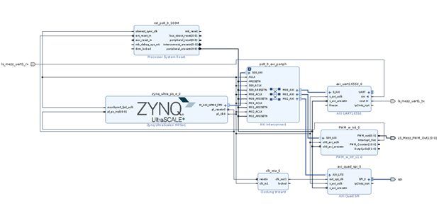

Updating the Design in Vivado
See part one for the step-by-step process.  I will be adding the AXI Quad SPI  and Clocking Wizard IPs alongside the existing UART and PWM IPs.  In addition, the AXI Quad SPI IP must be updated to use 2 slaves.  Having done that, the block design looks like this:
Having added an extra SPI slave, an additional pin is required:

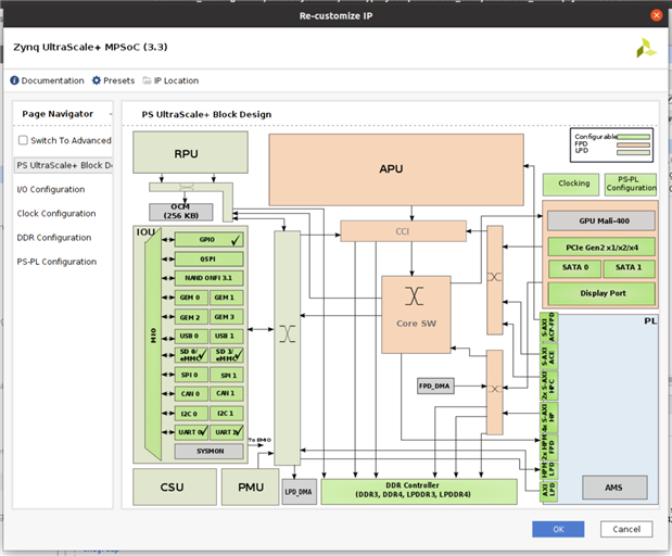

I also turned off some of the PL functionality that I don't need for this solution so the Block Diagram looks like this:
I can then run synthesis, implementation and generate the bitstream before exporting the hardware XSA file.

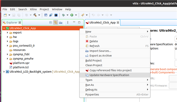

Update Hardware Specification
First things first: the HW design has changed so the project needs to be refreshed with the just exported XSA file:
It's worth re-building the platform project, which is now flagged as 'out of date' to save time later.

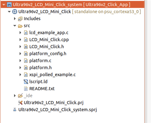

I could just build on these but I don't like the name which references the LCD backlight - I'm going to do more - and the location the projects are stored also reflects that name.  I'll create a new Application Project called Ultra96v2_LCD_Mini_Click, using the Standalone on psu_cortexa53_0 domain and use an Empty C++ Application template.  To make it simple, I can copy the Ultra96_v2_LCD_Backlight source files into the new project, renaming as necessary - I've called it lcd_example_app.c.  I also imported the code from my SPI_Test application created in Part One so that I can use that for reference; later I deleted it as it was no longer required.  My application src directory looks like this:
This is my coding jump-off point.  There isn't a blow-by-blow account as I write the code but I will take my normal cyclic approach of code-test-fix.  I also refactored the originally used code from the Workshop to make it easier for others to follow in the context of this application.

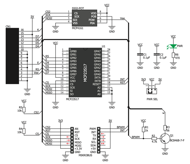

If you want to have a go at writing your own code, then the following will be useful and save you a bit of research time.  Checking the schematic for the LCD Mini Click:
Port Expander

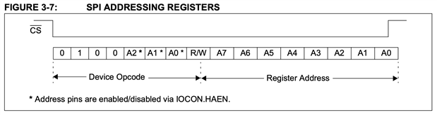

The Port Expander, MCP23S17, is using the Port B GPIOs and the LCD is only wired with 4 data pins thus operates in 4-bit mode; note that pins labelled RS and E are used in the writing of data to the LCD driver IC, HD44780U.  The MCP23S17 address pins A0, A1 and A2 are connected to ground giving the driver an address of 0x00.  This will need to be reflected in the code written.
To write to the MCP23S17, the master must send an OPCODE followed by REGISTER ADDRESS followed by one or more data bytes:
This application only writes to the SPI slave so the OPCODE will be 0b01000000.
The data sheet gives timing for SPI operations.  These are mostly in nanosecond duration and, where not, in very low micro second duration.  The code will (may) need to take account of this.

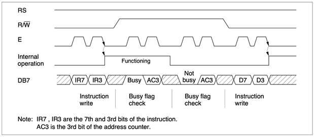

LCD and LCD Driver
The data sheet for the LCD refers to the driver IC as ST7066U which is a Hitachi HD44780U equivalent.  Actually, the data sheet is a little confused as it also refers to a ST7066U or equivalent.  During development, I found that the initialisation of the LCD was correctly achieved following the HD44780U datasheet, rather than the ST7066U data sheet, and thus that's the one I used going forward.
Writing to the LCD, or rather the LCD controller HD44780U, requires conformance to the following, in 4-bit mode:
For writing instruction data, the RS pin is kept low (Register Select, not Reset!).  To actually write in valid data the E pin must be toggled on then off (and should start off).  The high-order nibble is sent before the low-order nibble.  I couldn't find timings for the pulses but the instruction table does give execution times - I just need to build in suitable delays.  I'm not building a generic library for the LCD so I'm only implementing what is necessary for my own purposes.
The LCD is a 16x2 device but the driver is designed for 40x2.  Therefore, each line can contain up to 40 characters although only 16 are shown on the display (to use all 80 you would need to amend the buffer size I use in the software.)  To display off-screen characters, the display can be shifted left which will move off the left character and bring on a new right character.  The display DRAM addresses are consecutive so writing 45 characters, for example, will display characters 0 to 15 on line 1; 16 to 39 will be off-display on line 1; 40 to 44 will be on line 2.  Essentially, this can be viewed as 'wraparound'.
Digipot
The digipot is an MCP4161 IC - datasheet here - which is a single 10kOhm, 8-bit, non-volatile, potentiometer.  It is factory set to power up at midscale (0x80).  I just need to send it a suitable value between 0 and 256: a low value for 2-Line mode - I chose 30 which works well.

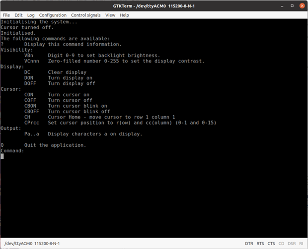

The running application on the Cortex A53 displays a set of available commands in the terminal:
E.g.
  1. DC
  2. CP06
  3. PHello
  4. CP14
  5. PElement14
Will display the message in the image below.

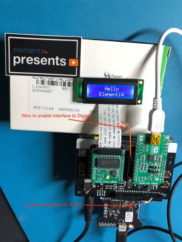

And the proof:
The cross-wiring to enable the PL to drive the SPI bus isn't that clear on the photo I'm afraid but I detailed it above and I didn't bother cross-connecting MISO as it wasn't needed for my purposes.
