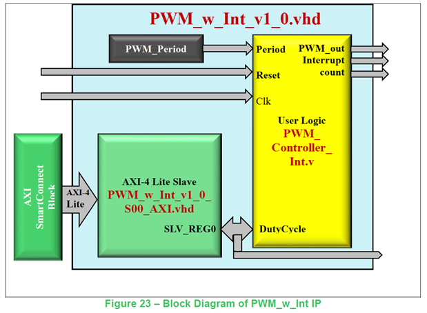

The PWM IP
The structure of the new IP is covered in the lab notes and I've taken the liberty of copying the block diagram below for reference:
Image copyright 2021, Avnet inc.
Note that this is an AXI-4 IP and provides for the following Inputs and Outputs:
  • Reset: INPUT
  • Clock: INPUT
  • PWM out: OUTPUT - to be connected to the Mezzanine LCD click board
  • Interrupt: OUTPUT - to indicate an invalid PWM setting
  • Count: OUTPUT - PWM counter for debug
  • Duty Cycle: OUTPUT - the duty cycle for debug
There are also 'internal' ports used:
  • SLV_REG0: to transfer the duty cycle from the AXI Slave.
  • Period: Actually, a parameter and not a Port but will be used to control the period for the PWM signal.  The overall PWM width is equal to 1,000,000 clock cycles and this parameter is set at 20 to divide it into .

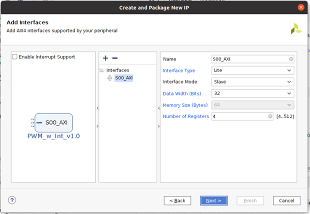

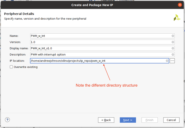

From the Tools menu in Vivado, select Create and Package IP, then select to create an AXI4 Peripheral.  This step is the same as that taken in the video with two exceptions, as I'll cover in a bit.  Use the following parameters for setting the Peripheral Details (the first exception):
My projects live in a subdirectory called 'projects' and I'm creating re-usable IPs so they will be in a specific subdirectory for all projects: 'ip_repo'.  Further, I've decided that each IP should be in its own sub directory because a number of files are created, as well as a, potentially long-lived, Vivado project.  This will keep them self contained.
When you click on Next, you'll see this dialog which is the same as the video and the information given in that is still relevant.
The final step is also the second exception:

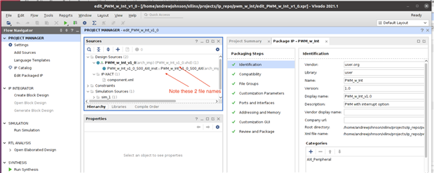

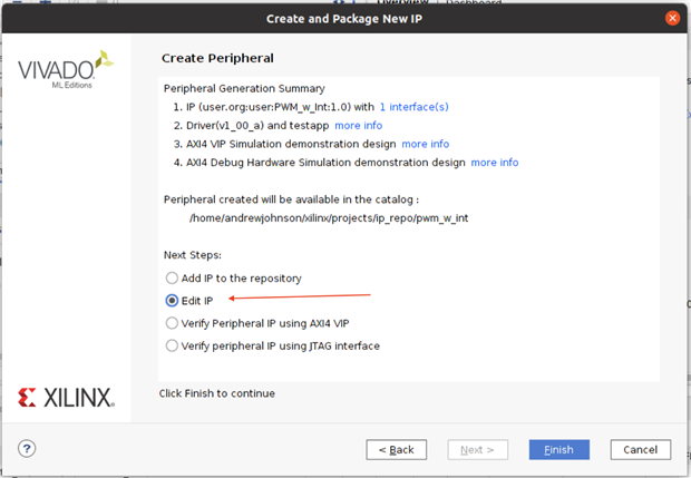

We are going to edit the IP immediately.  In the video, the IP is added to the repository so that various files can be copied into place before the IP is opened for editing: that's a step we're skipping.

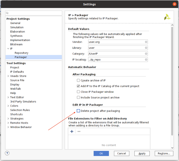

When you edit the IP, Vivado will create a new project for that IP if one doesn't already exist, and open it.
Note that it created two files for us and the astute will observe these match the names in the block diagram shown above; there's a third file mentioned in the block diagram which we'll come on to.  All changes to the IP will be done in this Vivado project which, by default, will be deleted when the IP is packaged.  That could be a bit of a pain, so make sure that this doesn't happen by changing this setting (and whilst your at it, make the changes to use VHDL if necessary):
Note that the project can always be deleted manually, it is stored in the same subdirectory as the IP.  You can also use this project to open up the IP directly if you need to come back to it later on.

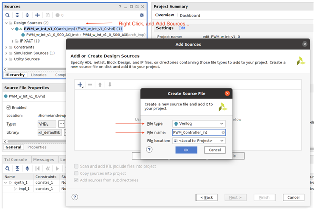

Let's add the new file.

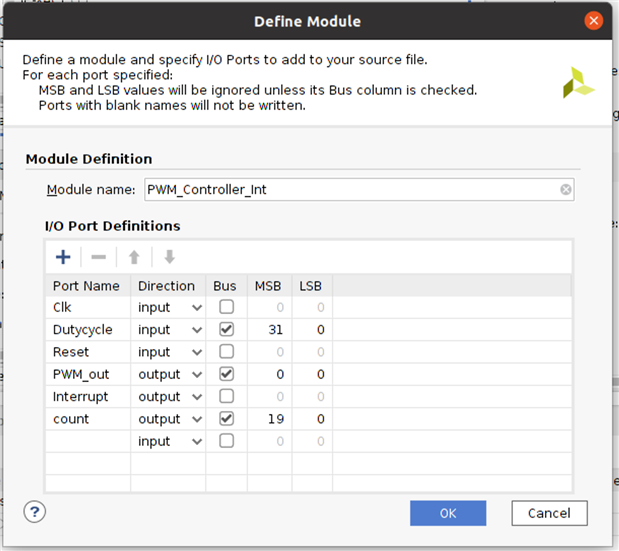

Add PWM_Controller_Int.v
Add a new source file to the project:
Right click and Add Sources, Create File and make sure you create it as a Verilog file with the name shown.  When you click on Ok, you'll be invited to Define a Module for the file - this sets up the Ports and you can refer back to the Block Diagram:
Enter the values as I show EXCEPT use DutyCycle rather than Dutycycle as I did.  If you missed that, don't worry, change it in the code when the file is created.  We'll be coming back to adjust the count Port shortly, but 19:0 is fine for now.  When you click Ok, the source file will be added into Design Sources - don't worry if the hierarchy structure doesn't look like that in the workshop, it will get sorted later.  If you open it to edit, it should look like:

module PWM_Controller_Int(
    input Clk,
    input [31:0] DutyCycle,
    input Reset,
    output [0:0] PWM_out,
    output Interrupt,
    output [19:0] count
endmodule
Port count actually defines the width of the pulse and is intended to be parameterised but at the moment is a fixed size of 20 (19 down to 0).  You may decided it's as easy to copy and paste the whole contents of the provided workshop file but I'm taking it step-by-step here.  We need to add the parameter and change the definition of counter accordingly; There are also some other subtle changes incorporated so be careful:

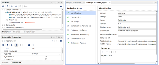

When you save the code, you'll notice that there is an adjustment to the Design Sources hierarchy such that the new file created is now indented under the PWM_w_Int_V1_0 file.  This is because it is used within that file as a component and instantiated as PWM_Controller_Int_Inst.
Packaging the IP
We're done with defining the IP, now we need to package it for use.  You can get to the Packaging Steps by double-clicking on the component.xml file:
The structure of Component.xml is an industry-standard way of representing IPs.  The Green flags represent steps that are good; the greyed flags are those that need addressing.
First, run Synthesis to validate the design and when it completes there should be no errors - you'll need to address them first if necessary.
At this point, you can follow the workshop steps from synthesising the IP onwards - Step 40 on page 25 of the lab notes.  Hopefully this has given you some insight into creating your own IP.
Makefile
It's worth pointing out that having followed these steps, there is no problem with the makefile as has been alluded to in the workshop.  Whatever the bug that was causing the issue has been resolved in this version of Vivado.

    One other thing that I previously hadn't noticed was the "Enable Interrupt Support" during the Add Interfaces dialog. I'd like to explore that a bit more to see what happens when you check that box since this IP does, in fact, have an interrupt.
