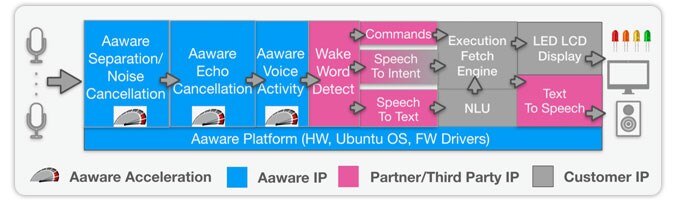

Here is a flow diagram of Aaware Embedded Voice with key integrated voice AI partners and typical customer specific IP.

The number one job for a great VUI is accuracy, which allows it to function ubiquitously. This all starts with cleaning up the sound field so the wake word and follow-on ASR and NLU technologies can recognize and understand the voice input. The Aaware voice capture algorithms include, proprietary spatial/spectral/temporal source separation, noise suppression, acoustic echo cancellation (AEC) and source localization that delivers low distortion audio of voice sources in the sound field.
Acceleration at the Edge
The Aaware DSP algorithms and AI models are accelerated using the FPGA fabric, optimizing performance, offloading the CPU, and reducing cost and power. Using the FPGA fabric, Aaware packs more audio processing in this dual core than is possible in traditional quad cores running at twice the clock speed allowing a full VUI to run on this Zynq 7010.
Pulling It All Together
The other major effort to making a VUI integrate more easily into your product is pulling the entire voice flow together into a flexible and open platform. This is where Aaware has partnered with key wake word and ASR/NLU providers, Picovoice and Sensory, and integrated their technology onto the AEV Platform. This combination gives product teams three different complete embedded voice flows integrated with our flexible multi-mic array and Xilnx Zynq All Programmable SoC. Customers can experiment with different mic array configurations (up to 13 mics) and integrate their embedded software within the  popular Ubuntu OS. The embedded software is powered within the Zynq SoC by dual 32-bit A9 ARM processors with NEONTm acceleration. The Aaware DSP algorithms and AI models are accelerated in FPGA hardware, optimizing performance, software footprint, cost, and power.
