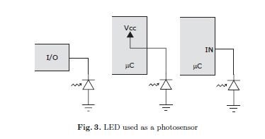

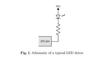

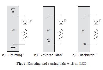

Using two digital i/o pins a microprocessor can be used to both emit and detect light through a LED. The concept is simple, switch the biasing of the diode for each condition depending on the circuit layout of the diode. Since the LED is a photodiode, sensitive to light that is above the spectrum at which it displays, it can be polled for the current light level it sees.
Then you simulate the biasing of the LED in the microcontroller to emit and detect. Depending on the number of LEDs, even a low frequency uC could handle the job.
The video attached to the post demonstrates how fast and accurate this interface can operate. Also attached is a document on building a touch LED interface, where the above Figure clips were taken from. My immediate idea is a fun interactive light wall for advertisement. But the versatility of this simple input has no bounds. Buttons for a device, a simple touch screen, a hand reconfigurable digital sign, to just name a few possibilities. But does it work in the dark?

    The connection is straightforward, just connect the junction of the resistor and LED to an ADC pin on the processor.
    The circuit I attached here (UNTESTED!) connects this point to a pin that can also be configured as a comparator on a PIC12HV615-I/MFPIC12HV615-I/MF.
    (Note the HV version has a built in shunt regulator, and the data sheet explains how to set the supply resistor.  If you use a regulated 5V supply then use a PIC12F615.  The resistor in the programming connector allows ICD2 or ICD3 to supply the power at 5V to the HV chip)
    The comparator can be set so that it enables a counter/timer in the PIC (it can drive the T1G) so you can also measure the time that the diode takes to discharge for detecting presence of light.
    The pin can be reconfigured in software to be ADC input to measure the voltage when the LED is driven forwards and is illuminated.
    The sketch also shows how you might connect a microchip temperature sensor, which you could use to compare the results.  The temperature reading from the LED will be coarse as the ADC will change somewhere around 1.2degrees per bit, but this would be good enough say to control a room heater.
    The software would need to drive the LED forward for say, 200uS to emit a small amount of light to bounce of a finger if the LED is touched.
    During this time the ADC can be used to read the voltage on the LED.
    Then reverse the drive to the LED for say another 200uS and set the Timer1 so that it counts until the comparator flips. The count value indicates how much light is there.
    Then spend say 1600uS (so the total loop is 2mS) with the LED driven either off or on according to whether it should be visible or not.
    The short pulse of light will make the LED glow faintly, but this would be useful to find the switch in the dark...
