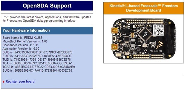

    Hi Azaj,
    Support for Windows 8/8.1, MacOS and Linux operating systems was added to Bootloader version 1.11 and MSD firmware version 1.14. Please make sure that your board is programmed with Bootloader version 1.11 or higher prior to attempting to update your OpenSDA board with a new firmware application.
    Please follow below steps to find out what version of Bootloader your board is programmed with:
    Start your board in Bootloader mode by holding down the RESET button prior to plugging it into USB port.
    1) Open the SDA_INFO.HTM file, which will contain version numbers of Bootloader as well name and version of current OpenSDA firmware you are using. If your board is not running Bootloader version 1.11 or higher you need to update Bootloader.
    Important: If you are currently running Bootloader version 1.10 or earlier, you will need to find a Windows XP or Windows 7 PC to perform this update.
    To update Bootloader please follow these steps:
    1. Enter bootloader mode (generally by holding down the target reset button on the OpenSDA board and plugging in the USB connection).
    2. Drag and drop the "BOOTUPDATEAPP.SDA" file to the root directory of the Bootloader "drive". (i have attached the OpenSDA Firmware which is downloaded from P&E Microcomputer Systems)
    ("BOOTUPDATEAPP.SDA" can be found in attached firmware location "\Pemicro_OpenSDA_Debug_MSD_Update_Apps_2014_05_22\OpenSDA_Bootloader_Update_App_v111_2013_12_11")
    3. Unplug and replug your OpenSDA board to initiate Bootloader update. Bootloader update should take less than 15 seconds (probably averages 3 seconds).
    4. Once update is complete, OpenSDA will automatically enumerate in Bootloader mode and green status LED will go on blinking with 0.5 second on/off intervals.
    5. Run the SDA_INFO.HTM file in the root directory of the Bootloader "drive".
    IMPORTANT: Please do not unplug OpenSDA while Bootloader is updating.
    Hope this works out for you.

    I found on my desk an old  FRDM-KL25ZFRDM-KL25Z with a Bootloader Version 1.09 and I could successfully update it to the Bootloader Version 1.11 on my Windows 7 computer following the instruction above and downloading the latest firmware BOOTUPDATEAPPPemicrov111.SDA available in the"OpenSDA Firmware(MSD Debug package downloadable from www.pemicro.com/opensda
