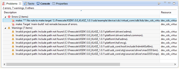

I am trying to setting up the envoirement to work with Kinetis design studio, what I do is:
- Install Kinetis design studio (in windows8)
- Install SDK (in windows8)
- Install SDK in Kinetis design studio (Install new software, searching the KSDK_1.0.0_KL43Z_1.0.2_Eclipse_Update.zip file...), as indicated in KDS user guide
The problem I have, is that every time I import an example (only tried usb examples), the linked resources does not point correctly and I have to change them manually. The adater file alo seems not to be well pointed because I chose bare metal and it was building like an OS was selected.
So, probably I am doing something wrong but I cannot guess what.
Anyone can help me? Does any guide or similar for using SDK examples in KDS?

    Thanks bheemarao, but...
    I am sad to say no... image
    The problem is that I import examples from C:\Freescale\KSDK1.0.0_KL43Z_1.0.1\usb\example\device, not from demos folder.
    And I get this:
    Examples from demos folder builds ok.
    Thanks

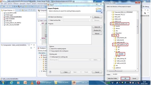

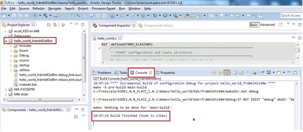

  • bheemarao
    0 bheemarao over 11 years ago in reply to gihu
    Hi,
    After installing the "KSDK1.0.0_KL43Z_1.0.1" from freescale wesite you need to build platform library for KL43Z board as shown for K64 in my blog,
    i did the build for platform library for KL43Z board by importing the library platform from below path "C:\Freescale\KSDK1.0.0_KL43Z_1.0.1\lib\ksdk_platform_lib\kds\KL43Z4"
    it will compile with no errors, now you can add your demo example from "C:\Freescale\KSDK1.0.0_KL43Z_1.0.1\demos" and import the required project.
    i imported 'hello_world_frdmkl43z48m' project and build/compiled, it was successful with no errors.
    please try the same at your end and let me know.

    0 gihu over 11 years ago in reply to bheemarao
    Yeah, I was doing this. I was building first the driver library, and it works for demo projects.
    But, the problem was that it is not enough for usb examples, it should be built also a usb library, in this case "usbd_sdk_frdmk43z48m_bm" lib. Once built this two libraries I can build the usb example.
    Thanks for your support!!

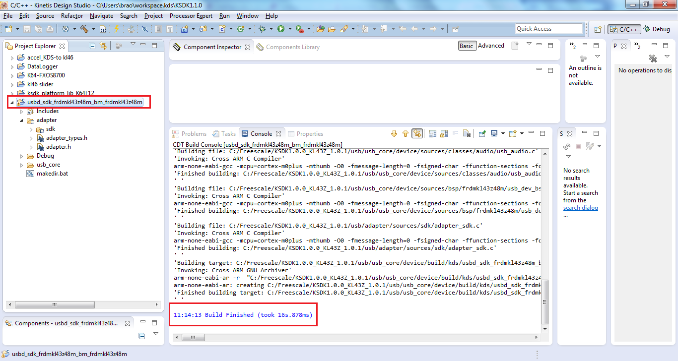

  • bheemarao
    Hi Miguel,
    Thanks for the reply.
    In my case when i added the bare metal project (usbd_sdk_frdmkl43z48m_bm) by importing from the path "C:\Freescale\KSDK1.0.0_KL43Z_1.0.1\usb\usb_core\device\build\kds" it is building with out any errors.
    the only thing in my KDS tools is i have upgraded to KSDK1.1.0, but the SDK support for KL43Z is provided for "KSDK1.0.0_KL43Z_1.0.1" you can change the project path to KSDK 1.0.0 at the beginning of creating workspace. just try this once.
    Best Regards
    Bheema Rao
