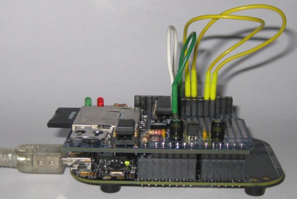

Data Logger Shield on Top of Freedom Board
Data Logger Shield Hardware

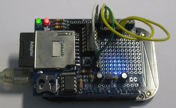

I ordered a the Adafruit Data Logger Shield as a kit: to solder such a kit is fun :-) , and gives me the freedom what to put on the board. The schematics of the shield can be found here.
The board features an SD card with level shifter (required to work with 3.3V and 5V devices), two LED’s, a reset button, an I2C battery buffered realtime clock plus a prototype area. The minimal SD card pins (MISO, MOSI, DeviceSelect, BusCock) and I2C (SDA, SCL) bus are connected to the shield connector rows, while the two LEDs and the card write protect and card detect pins can be routed to any pins with a wire or any other kind of connection.
Data Logger Top View
In above picture the green wire is for WP (SD card Write Protection pin), the white wire is for the CD (SD Card Detect) pin. The yellow wires are for the red and green LED.

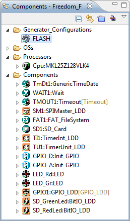

Freedom_FatFS Processor Expert Components
  • GenericTimeDate: needed for date and time information, as the file system needs date/time attributes for files on the file system
  • Wait: generic busy wait routines, needed by the SD card driver because initialization of the SD card driver needs to wait for a time as specified in the SD card standard.
  • Timeout: As SD card operations can take a very long time (several hundreds of milliseconds), this timeout driver allows to wait for a given time.
  • SPIMaster_LDD: implements the SPI bus driver using interrupts.
  • FAT_FileSystem: Implements the FAT file system.
  • SD_Card: Low level SD card driver implementing the memory device.
  • TimerInt_LDD and TimerUnit_LDD: implement a 10 ms timer used for the Timeout component.
  • Init_GPIO: Init components used for pull up resistors for the WP and CD signals (see this tutorial).
  • LED and GPIO_LDD: Driver for the RGB LED on the Freedom board (see this tutorial). Note that the signal for the blue RGB LED is used for the SD card SPI clock signal by the Data Logger Shield.
  • BitIO_LDD: Used for the green and red LED on the shield (see this tutorial).

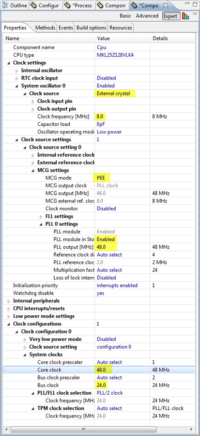

KL25Z with 48 MHz
In order to run the SPI bus with up to 12 MHz, the CPU core clock is configured to run at 48 MHz:
48 MHz Core Clock

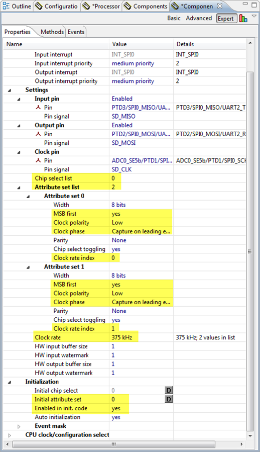

SPIMaster_LDD Configuration
The SPI component needs to be configured for the MISO, MOSI and CLK pins, *without* :!: Chip select and two :!: clock configurations, each with ‘MSB first’, ‘Low Clock polarity’ and ‘capture on leading edge’:
SPI Configuration

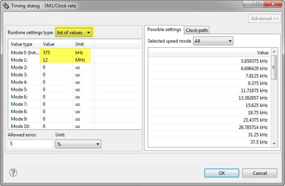

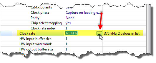

The Attribute Set 0 needs to point to Clock rate index 0, and the so the Attribute Set 1 to Clock rate index 1. The reason is that we need to SPI clock speeds: a maximum of 400 kHz for card initialization and up to 20 MHz for normal operation. What we can achieve here is 375 kHz and 12 MHz.
The two speed modes need to be set in the clock rate settings:
Clock Rate Settings
In the Timing Dialog the two SPI clock speeds need to be configured with ‘list of values’:
Timing Dialog

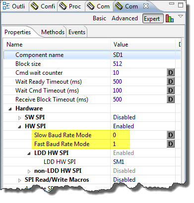

The two speed modes are referenced from the SD_Card component properties:
Slow and Fast Speed Modes

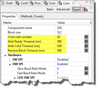

Timeout Component
As the SD card requires up to several hundreds of milliseconds delay, the Timeout component is used.
SD_Card Timeout Properties
For this a 10 ms timer is configured with the TimerInt_LDD component. What easily gets missed is to call the AddTick() method in Events.c from the 10 ms timer interrupt:

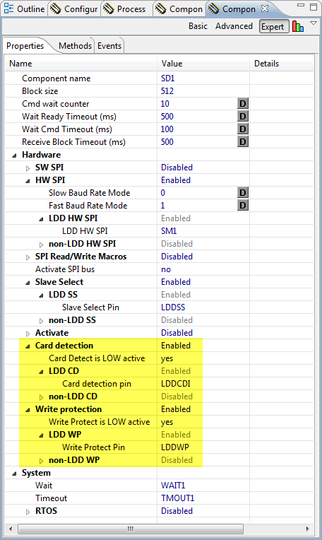

Optionally the SD card holder can provide WP (Write Protect) and CD (Card Detect) signals. They are available in the SD_Card component settings:
CD and WP Pins
If the signals do not have pull-ups or pull-down resistors on the board (as for my shield), they need to be configured in ‘pin-sharing’ mode and with pull-ups enabled (see this tutorial).
The WP signal is connected to the shield D8 line, and the CD signal is connected to D9.

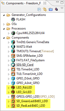

LED’s
The projects used the RGB LED on the Freedom board plus the two LED’s on the Shield. The two shield LED’s are connected to the shield D7 and D6 lines.
LED Components in Component View
