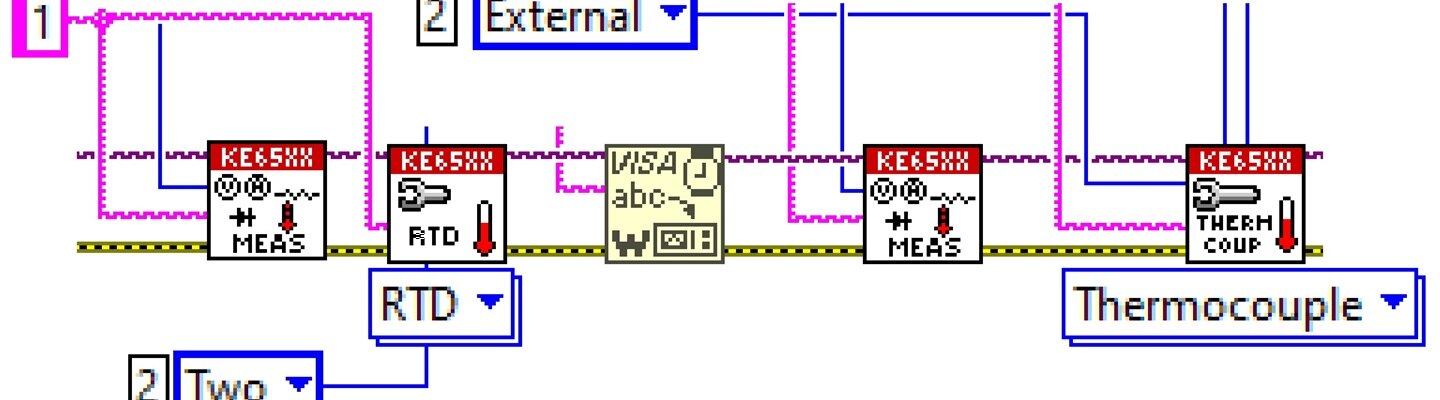

Adapted DMM6500 Driver example
The Keithley LabVIEW driver has examples for two scenarios: simulated cold junction compensation, or the internal compensation available on their excellent 2001-TSCAN card. I added the external option, so that I could use my Pt100 sensor:
image: the cold junction reference and the thermocouple channels configuration. I also gave it a name (RJUN).
image: Before sampling, I take care that the cold junction reference channel is added in front of the selected thermocouple channel list. It needs to be sampled before the thermocouples to get the best results
The driver example's front panel is adapted to remove the simulation field. All the rest was kept the same. Here is a single sample taken with the Pt100 compensation. Result 2 is again the thermocouple's compensated measurement. Result 1 shows the value reported by the Pt100.
