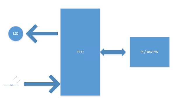

The basic structure is illustrated as below:

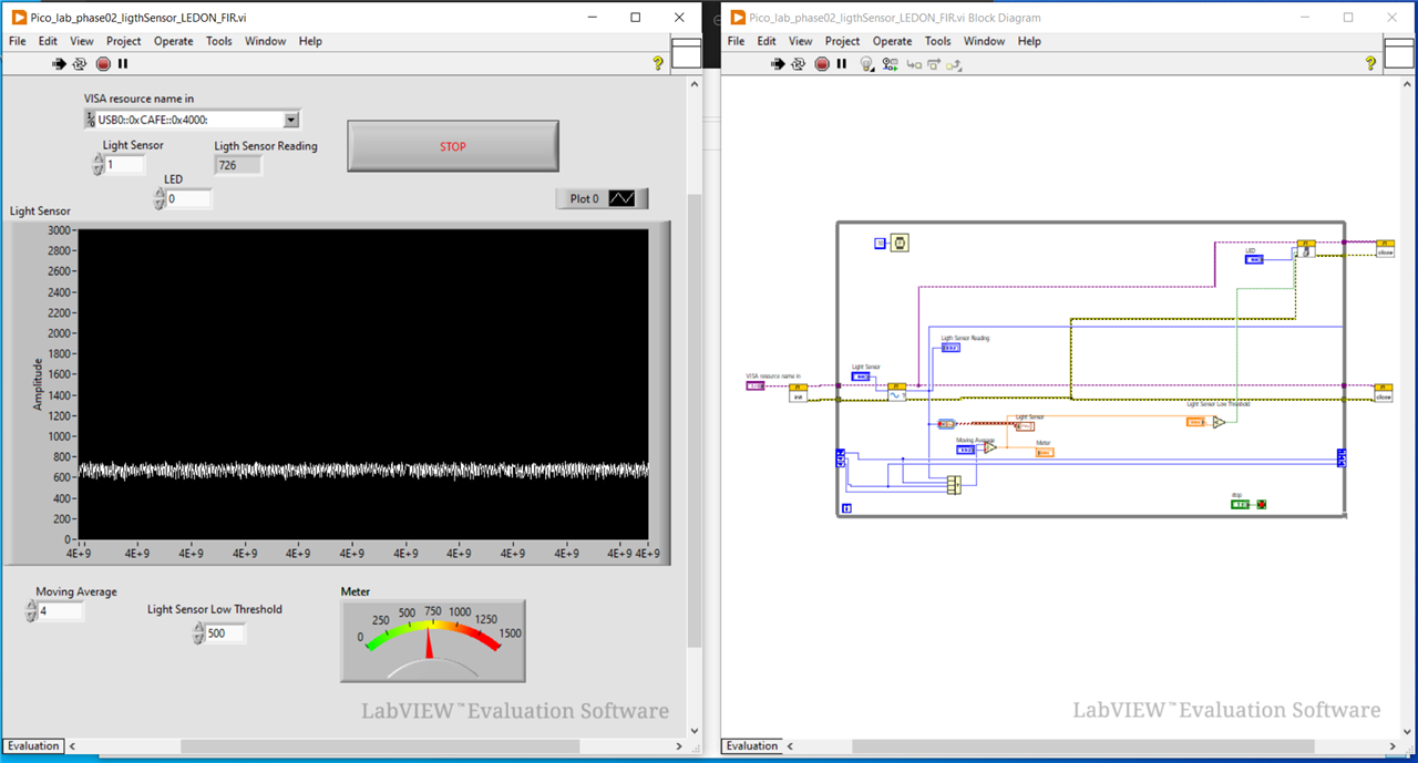

There are three buildings blocks: Pi Pico,  LED and Light sensor.  I used a moving average feature from LabVIEW to reduce the noise of the light sensor as below.The light senor is TEMT6000 module from my LinkSprite IoT lab kit.
The real work bench and virtual workbench photo is presented as below.
Here is the video record of light sensing to control LED ON/OFF if the light sensor reading data is lower than 500 from the Pi Pico ADC pin.
 Here is the final LabVIEW project for light sensor switching LED On/Off.
