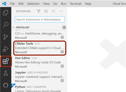

Install Visual Studio Code
Follow the Visual Studio Code website information to install it. Then, install the extension CMake Tools as shown here:

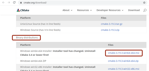

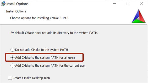

Install CMake
Download and install:
During install select this option:

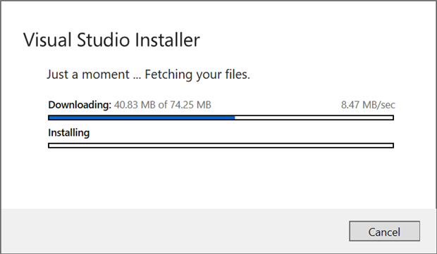

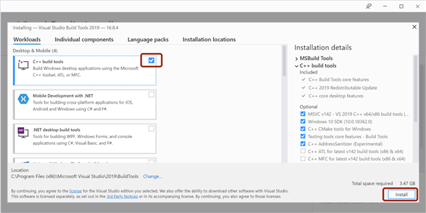

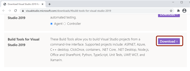

Install Build Tools for Visual Studio
It will launch the installer:
Select C++ build tools and install it. It may take several minutes to complete.

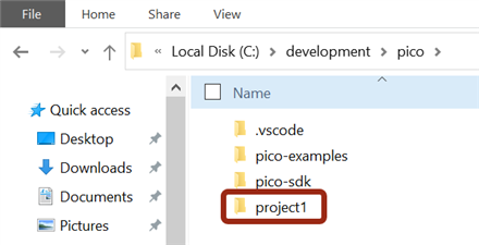

Create a pico folder (C:\development\pico for example) and navigate to it.
Follow the Pico user guide and type commands in a Windows command prompt to download and install the SDK and examples as shown in the screenshot below (Note: If the git commands do not work, then you'll need to install git on your PC. See here for details on how to install git ).
Note: In the past, it was OK to just copy the pico SDK and examples folders from GitHub but that doesn't work anymore, so definitely follow the steps shown above, because the git submodule command in the screenshot above is used to pull in content from other locations too, as part of the SDK install.
By the end of this, you should have a pico-sdk folder, and a pico-sdk-examples folder, both within the pico folder.

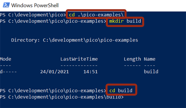

Building at the Command Line

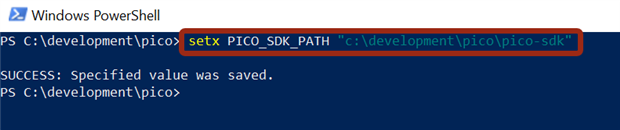

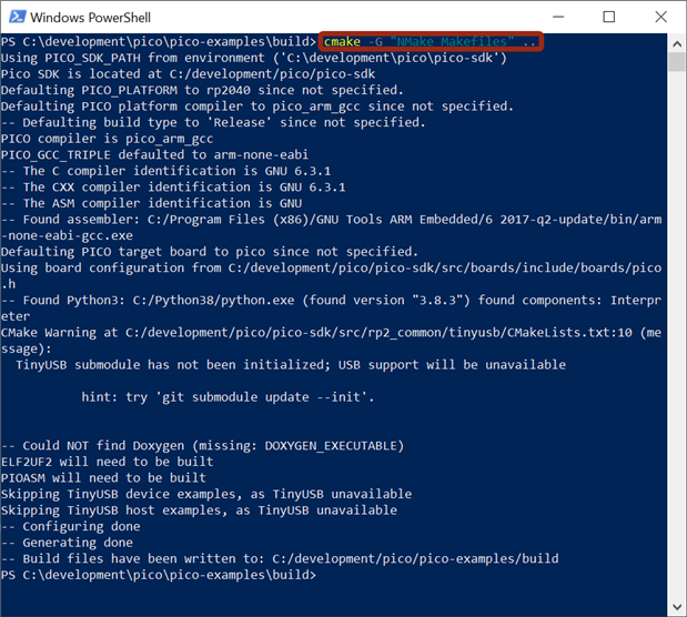

Start up PowerShell and type the following:
Close PowerShell and open a new PowerShell. Type the following to create a build folder inside pico-examples, and then navigate to it:
Now type:
cmake -G "NMake Makefiles" ..

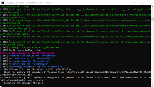

Now to build the code, the environment variables for Microsoft build tools (particularly nmake) might not be set up properly to work in PowerShell. If you get an error, switch to using Developer Command Prompt for VS 2019 instead.
Open up the prompt and navigate to the build folder as before, and then just type nmake
It will start building all the examples (it will take a while).

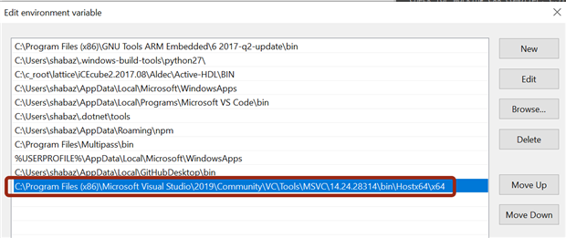

I had Nmake not found issues when attempting to use Visual Code to do the build. The fix for me was to go to the Environment Variables in Windows, and add this to the Path variable:
I did it for User and System variables. Note that you’ll need to check this path exists on your machine first. It may be similar but subtly different, so it needs to be checked.

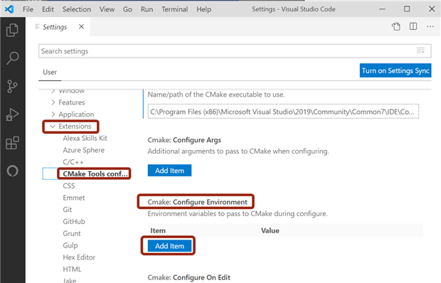

Building with Visual Code
Note: Make sure you can successfully build at the command line before trying these steps.

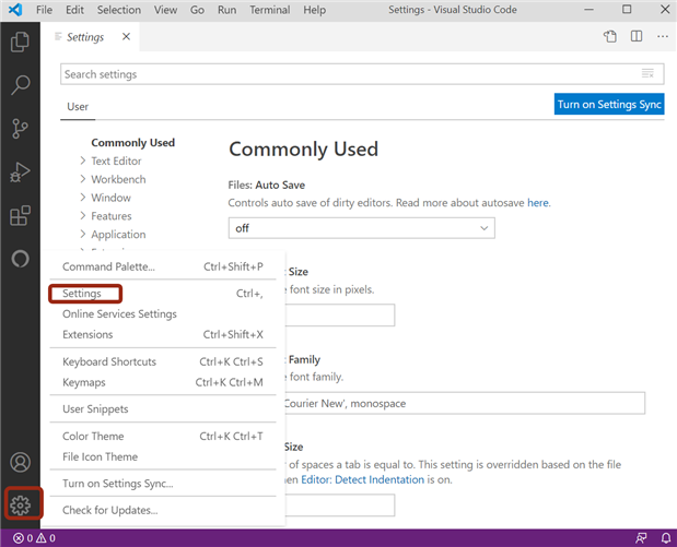

Click on the cog at the bottom-left of the window, and select Settings:

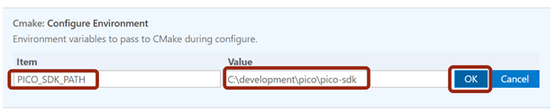

Expand Extensions, select CMake Tools configuration, scroll to Cmake: Configure Environment and click on Add Item as shown here:
Set as shown here:

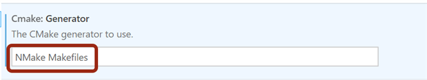

Next, scroll to locate Cmake: Generator and configure as follows:

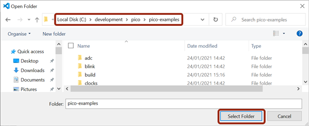

Close the Settings, and then go to File->Open Folder

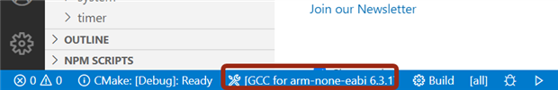

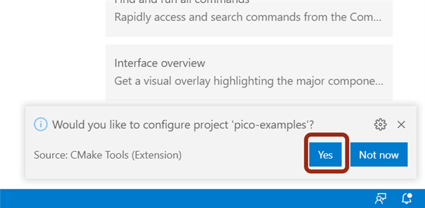

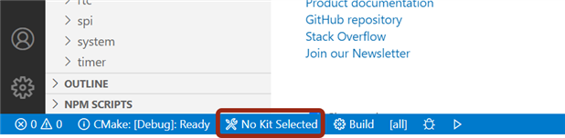

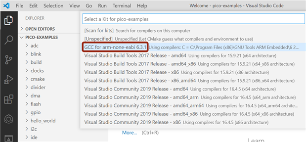

After you click Select Folder, at the bottom-right of the window, you’ll see this following pop-up. Click on Yes:
Incidentally, note that Visual Studio Code often creates plenty of pop-ups to the lower-right. You can generally ignore them (unless there is an error, or warning of interest), there is usually a flood of pop-ups whenever you open a new file and Visual Studio Code becomes eager to offer extensions and tips to work better with the files.
Then select GCC for arm-none-eabi:

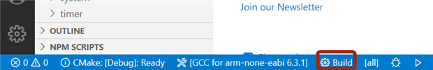

If you miss seeing the popup, you can just select in the blue bar at the bottom of the window, No Kit Selected, and then select GCC for arm-none-eabi
The blue bar will look like this:

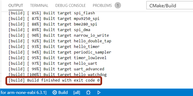

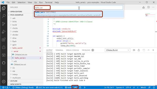

In this blue bar, click on Build:
After a long time (perhaps five minutes), all the examples will be built. You can see the output by clicking on View->Output. Don’t forget to click on PROBLEMS to see any warnings or errors if the build fails.
Note that if you wish to subsequently only build a single demo, you can save the build tools from traversing all the folders. To do that, click on the text [all] to the right of the Build text on that blue bar. A whole list of targets will appear. If you're only interested in (say) the hello_serial program that is in the hello_world folder, then start typing hello_serial in the box that will appear, and then select that target. From then on, clicking Build will only build that target. You can revert back to building all targets by clicking there again and this time selecting all.
Running the Application

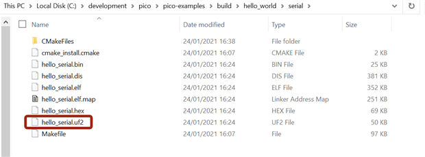

Go into the appropriate folders as shown in the screenshot below, to see the .uf2 file (if you cannot see any file suffixes you should change the View settings in File Explorer so that you can always see suffixes):
The .uf2 file can be dragged into the USB storage drive letter that appears when you hold down the BOOTSEL button and plug the Pico's USB connection into your PC (release the button after you've plugged the Pico into the PC). The application should become programmed into the Flash storage and begin execution. It may get tiresome frequently unplugging and plugging in the USB connection just to perform the reset. You can hard-wire a reset switch to the Pico. For information on this, see Debugging the Raspberry Pi Pico on Windows 10

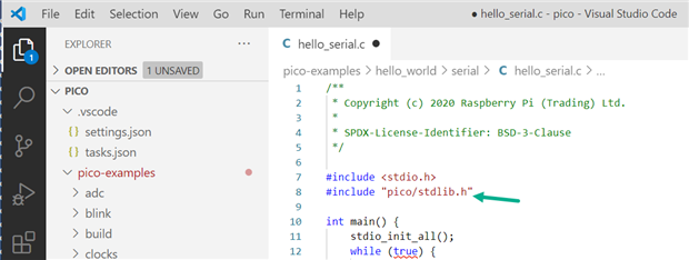

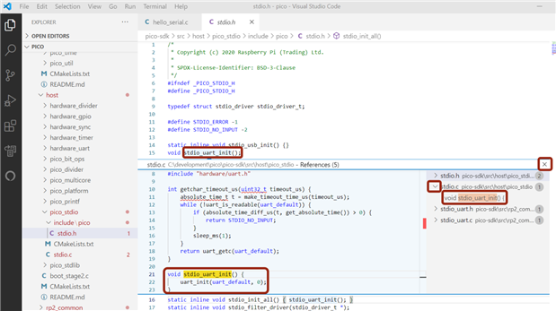

Using Intellisense (Code Assistance)

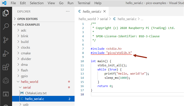

If you start up Visual Studio Code and select the pico-examples folder and look at any source code, you'll notice perhaps some squiggly lines like this:
It is a benign issue to the extent that it won't affect your project when you compile it. However, you want to ideally fix the squiggly line issue, because it means that Visual Studio Code can then help you write code more easily, by allowing you to navigate across code files simply by clicking your cursor in the function name, and pressing F12 (or right-clicking and selecting Go to Definition). Intellisense will also help as you're typing code, by providing good auto-completions.
For example, if you press F12 on the line that says stdio_init_all(); if Intellisense is not working then you'll find nothing. It will not be possible to easily tell in which file the function stdio_init_all exists, nor what it does. If Intellisense was working, you'd instantly know.
To get Intellisense working, I don't know the correct way, but here's what works for me (kind-of).
In Visual Code, select File->Close Folder. Then, instead of opening the C:\development\pico\pico-examples folder, instead select File->Open Folder and select C:\development\pico (i.e. one folder up).
Now if you open the code file, the squiggles will be gone:
(Note that there are squiggles on true and false, you can eliminate the squiggles for true and false by inserting #include <stdbool.h> into the code).
Now if you click on stdio_init_all and press F12, Visual Studio Code will instantly bring up the header file that defines that function. That header file is called stdio.h incidentally.
Another cool thing is that if you now look at this header file, you can immediately see that the function actually just calls stdio_uart_init. And if you click on that and then right-click and select Go to References (or hold Shift and press F12), a blue and gray pop-up appears. Select the closest reference on the right side in the gray area, and you'll see the implementation of the function in the blue area! Click on the X to close it at any time.
In summary, Intellisense used in that manner provides great insight when looking at existing code.

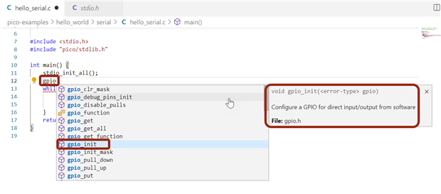

Here's another way that Intellisense helps, as you code; if you begin to type something (say gpio) then Visual Studio Code will automatically list some completions. You can use your cursor keys to choose the one you want (and it will display some helpful information too), and then press Enter to auto-complete.
Unfortunately, by opening the C:\development\pico folder instead of C:\development\pico\pico-examples folder, it breaks one (minor) thing: it is no longer possible to build the code using the blue bar at the bottom of Visual Studio Code. However, the workaround is simple. Just use a Windows Developer Command Prompt and type nmake as described before (in the section titled Building at the Command Line).

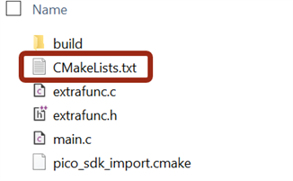

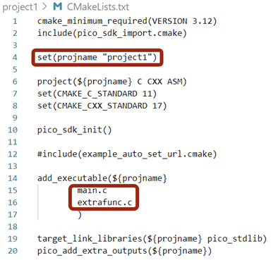

Creating your Own Project Folder
At the bottom of this blog post (just before the comments section starts), there is an attachment called project1.zip. If you download that and extract it into the pico folder (for example C:\development\pico) then it will look like this:
Next, rename the project1 folder to whatever you want to call your project (for example myproject1). Double-click to open the folder and these files will be present:
The important one to edit is CMakeLists.txt. It will contain the following (see the screenshot below). Change the text project1 to be your new project name. Also, you can see that the code is comprised of main.c and extrafunc.c - all the pico examples use a single C file, but I figured I'd create an example project with an additional file so it can be seen how to add more files.
That's it, you can now use Windows Developer Command Prompt and go into the c:\development\pico\myproject1\build folder, and type (as before):
After that, to perform the build, type (as before) in the Developer Command Prompt:
nmake
It will result in the myproject1.uf2 file being created in the build folder, and you can transfer it to the Pi Pico as described before.
You can repeat these steps to create as many projects as desired : )

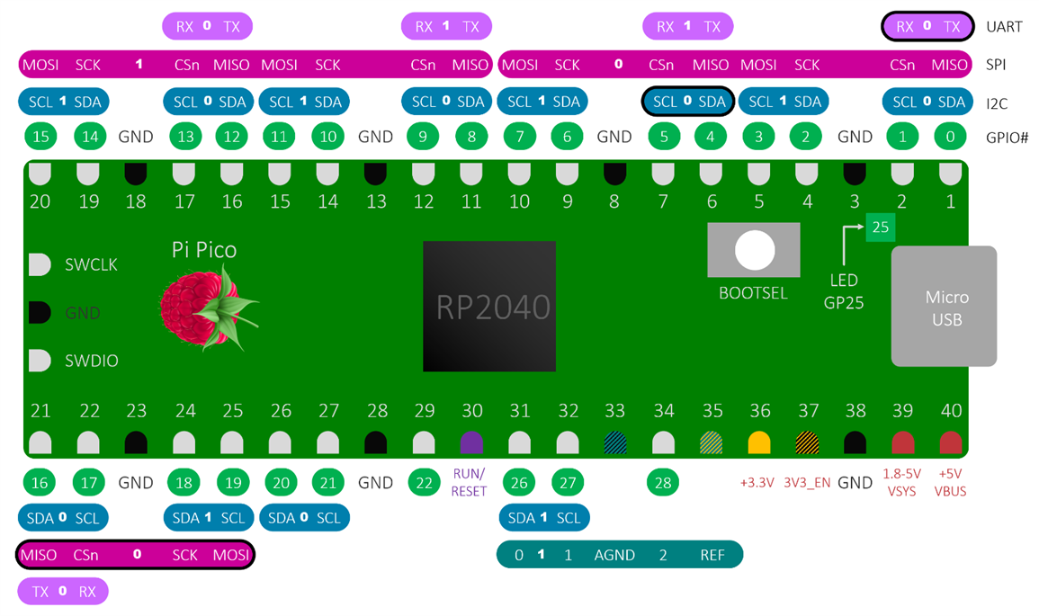

    Just noticed today that every Pi pinout diagram is vertical! For the times a more horizontal approach is preferred:
    Slightly more printer-friendly version:

    Scanning dependencies of target ELF2UF2Build
    [  1%] Creating directories for 'ELF2UF2Build'
    [  3%] No download step for 'ELF2UF2Build'
    [  5%] No update step for 'ELF2UF2Build'
    [  6%] No patch step for 'ELF2UF2Build'
    [  8%] Performing configure step for 'ELF2UF2Build'
    -- The C compiler identification is MSVC 19.28.29912.0
    -- The CXX compiler identification is MSVC 19.28.29912.0
    -- Detecting C compiler ABI info
    -- Detecting C compiler ABI info - done
    -- Check for working C compiler: C:/Program Files (x86)/Microsoft Visual Studio/2019/Community/VC/Tools/MSVC/14.28.29910/bin/Hostx86/x86/cl.exe - skipped
    -- Detecting C compile features
    -- Detecting C compile features - done
    -- Detecting CXX compiler ABI info
    -- Detecting CXX compiler ABI info - done
    -- Check for working CXX compiler: C:/Program Files (x86)/Microsoft Visual Studio/2019/Community/VC/Tools/MSVC/14.28.29910/bin/Hostx86/x86/cl.exe - skipped
    -- Detecting CXX compile features
    -- Detecting CXX compile features - done
    -- Configuring done
    -- Generating done
    -- Build files have been written to: I:/Embedded/RaspiPico/project1/build/elf2uf2
    [ 10%] Performing build step for 'ELF2UF2Build'
    Microsoft (R) Program Maintenance Utility Version 14.28.29912.0
    Copyright (C) Microsoft Corporation.  All rights reserved.
    Scanning dependencies of target elf2uf2
    [ 50%] Building CXX object CMakeFiles/elf2uf2.dir/main.cpp.obj
    main.cpp
    I:\Embedded\RaspiPico\pico-sdk\tools\elf2uf2\main.cpp(325): warning C4996: 'fopen': This function or variable may be unsafe. Consider using fopen_s instead. To disable deprecation, use _CRT_SECURE_NO_WARNINGS. See online help for details.
    I:\Embedded\RaspiPico\pico-sdk\tools\elf2uf2\main.cpp(331): warning C4996: 'fopen': This function or variable may be unsafe. Consider using fopen_s instead. To disable deprecation, use _CRT_SECURE_NO_WARNINGS. See online help for details.
    [100%] Linking CXX executable elf2uf2.exe
    [100%] Built target elf2uf2
    [ 11%] No install step for 'ELF2UF2Build'
    [ 13%] Completed 'ELF2UF2Build'
    [ 13%] Built target ELF2UF2Build
    Scanning dependencies of target bs2_default
    [ 15%] Building ASM object pico-sdk/src/rp2_common/boot_stage2/CMakeFiles/bs2_default.dir/boot2_w25q080.S.obj
    [ 16%] Linking ASM executable bs2_default.elf
    [ 16%] Built target bs2_default
    Scanning dependencies of target bs2_default_padded_checksummed_asm
    [ 18%] Generating bs2_default.bin
    [ 20%] Generating bs2_default_padded_checksummed.S
    [ 20%] Built target bs2_default_padded_checksummed_asm
    Scanning dependencies of target project1
    [ 21%] Building C object CMakeFiles/project1.dir/main.c.obj
    [ 23%] Building C object CMakeFiles/project1.dir/extrafunc.c.obj
    [ 25%] Building C object CMakeFiles/project1.dir/I_/Embedded/RaspiPico/pico-sdk/src/rp2_common/pico_stdlib/stdlib.c.obj
    [ 26%] Building C object CMakeFiles/project1.dir/I_/Embedded/RaspiPico/pico-sdk/src/rp2_common/hardware_gpio/gpio.c.obj
    [ 28%] Building C object CMakeFiles/project1.dir/I_/Embedded/RaspiPico/pico-sdk/src/rp2_common/hardware_claim/claim.c.obj
    [ 30%] Building C object CMakeFiles/project1.dir/I_/Embedded/RaspiPico/pico-sdk/src/rp2_common/hardware_sync/sync.c.obj
    [ 31%] Building C object CMakeFiles/project1.dir/I_/Embedded/RaspiPico/pico-sdk/src/rp2_common/pico_platform/platform.c.obj
    [ 33%] Building C object CMakeFiles/project1.dir/I_/Embedded/RaspiPico/pico-sdk/src/rp2_common/hardware_uart/uart.c.obj
    [ 35%] Building ASM object CMakeFiles/project1.dir/I_/Embedded/RaspiPico/pico-sdk/src/rp2_common/hardware_divider/divider.S.obj
    [ 36%] Building C object CMakeFiles/project1.dir/I_/Embedded/RaspiPico/pico-sdk/src/common/pico_time/time.c.obj
    [ 38%] Building C object CMakeFiles/project1.dir/I_/Embedded/RaspiPico/pico-sdk/src/common/pico_time/timeout_helper.c.obj
    [ 40%] Building C object CMakeFiles/project1.dir/I_/Embedded/RaspiPico/pico-sdk/src/rp2_common/hardware_timer/timer.c.obj
    [ 41%] Building C object CMakeFiles/project1.dir/I_/Embedded/RaspiPico/pico-sdk/src/common/pico_sync/sem.c.obj
    [ 43%] Building C object CMakeFiles/project1.dir/I_/Embedded/RaspiPico/pico-sdk/src/common/pico_sync/lock_core.c.obj
    [ 45%] Building C object CMakeFiles/project1.dir/I_/Embedded/RaspiPico/pico-sdk/src/common/pico_sync/mutex.c.obj
    [ 46%] Building C object CMakeFiles/project1.dir/I_/Embedded/RaspiPico/pico-sdk/src/common/pico_sync/critical_section.c.obj
    [ 48%] Building C object CMakeFiles/project1.dir/I_/Embedded/RaspiPico/pico-sdk/src/common/pico_util/datetime.c.obj
    [ 50%] Building C object CMakeFiles/project1.dir/I_/Embedded/RaspiPico/pico-sdk/src/common/pico_util/pheap.c.obj
    [ 51%] Building C object CMakeFiles/project1.dir/I_/Embedded/RaspiPico/pico-sdk/src/common/pico_util/queue.c.obj
    [ 53%] Building C object CMakeFiles/project1.dir/I_/Embedded/RaspiPico/pico-sdk/src/rp2_common/pico_runtime/runtime.c.obj
    [ 55%] Building C object CMakeFiles/project1.dir/I_/Embedded/RaspiPico/pico-sdk/src/rp2_common/hardware_clocks/clocks.c.obj
    [ 56%] Building C object CMakeFiles/project1.dir/I_/Embedded/RaspiPico/pico-sdk/src/rp2_common/hardware_watchdog/watchdog.c.obj
    [ 58%] Building C object CMakeFiles/project1.dir/I_/Embedded/RaspiPico/pico-sdk/src/rp2_common/hardware_xosc/xosc.c.obj
    [ 60%] Building C object CMakeFiles/project1.dir/I_/Embedded/RaspiPico/pico-sdk/src/rp2_common/hardware_pll/pll.c.obj
    [ 61%] Building C object CMakeFiles/project1.dir/I_/Embedded/RaspiPico/pico-sdk/src/rp2_common/hardware_vreg/vreg.c.obj
    [ 63%] Building C object CMakeFiles/project1.dir/I_/Embedded/RaspiPico/pico-sdk/src/rp2_common/hardware_irq/irq.c.obj
    [ 65%] Building ASM object CMakeFiles/project1.dir/I_/Embedded/RaspiPico/pico-sdk/src/rp2_common/hardware_irq/irq_handler_chain.S.obj
    [ 66%] Building C object CMakeFiles/project1.dir/I_/Embedded/RaspiPico/pico-sdk/src/rp2_common/pico_printf/printf.c.obj
    [ 68%] Building ASM object CMakeFiles/project1.dir/I_/Embedded/RaspiPico/pico-sdk/src/rp2_common/pico_bit_ops/bit_ops_aeabi.S.obj
    [ 70%] Building C object CMakeFiles/project1.dir/I_/Embedded/RaspiPico/pico-sdk/src/rp2_common/pico_bootrom/bootrom.c.obj
    [ 71%] Building ASM object CMakeFiles/project1.dir/I_/Embedded/RaspiPico/pico-sdk/src/rp2_common/pico_divider/divider.S.obj
    [ 73%] Building ASM object CMakeFiles/project1.dir/I_/Embedded/RaspiPico/pico-sdk/src/rp2_common/pico_double/double_aeabi.S.obj
    [ 75%] Building C object CMakeFiles/project1.dir/I_/Embedded/RaspiPico/pico-sdk/src/rp2_common/pico_double/double_init_rom.c.obj
    [ 76%] Building C object CMakeFiles/project1.dir/I_/Embedded/RaspiPico/pico-sdk/src/rp2_common/pico_double/double_math.c.obj
    [ 78%] Building ASM object CMakeFiles/project1.dir/I_/Embedded/RaspiPico/pico-sdk/src/rp2_common/pico_double/double_v1_rom_shim.S.obj
    [ 80%] Building ASM object CMakeFiles/project1.dir/I_/Embedded/RaspiPico/pico-sdk/src/rp2_common/pico_int64_ops/pico_int64_ops_aeabi.S.obj
    [ 81%] Building ASM object CMakeFiles/project1.dir/I_/Embedded/RaspiPico/pico-sdk/src/rp2_common/pico_float/float_aeabi.S.obj
    [ 83%] Building C object CMakeFiles/project1.dir/I_/Embedded/RaspiPico/pico-sdk/src/rp2_common/pico_float/float_init_rom.c.obj
    [ 85%] Building C object CMakeFiles/project1.dir/I_/Embedded/RaspiPico/pico-sdk/src/rp2_common/pico_float/float_math.c.obj
    [ 86%] Building ASM object CMakeFiles/project1.dir/I_/Embedded/RaspiPico/pico-sdk/src/rp2_common/pico_float/float_v1_rom_shim.S.obj
    [ 88%] Building C object CMakeFiles/project1.dir/I_/Embedded/RaspiPico/pico-sdk/src/rp2_common/pico_malloc/pico_malloc.c.obj
    [ 90%] Building ASM object CMakeFiles/project1.dir/I_/Embedded/RaspiPico/pico-sdk/src/rp2_common/pico_mem_ops/mem_ops_aeabi.S.obj
    [ 91%] Building ASM object CMakeFiles/project1.dir/I_/Embedded/RaspiPico/pico-sdk/src/rp2_common/pico_standard_link/crt0.S.obj
    [ 93%] Building CXX object CMakeFiles/project1.dir/I_/Embedded/RaspiPico/pico-sdk/src/rp2_common/pico_standard_link/new_delete.cpp.obj
    [ 95%] Building C object CMakeFiles/project1.dir/I_/Embedded/RaspiPico/pico-sdk/src/rp2_common/pico_standard_link/binary_info.c.obj
    [ 96%] Building C object CMakeFiles/project1.dir/I_/Embedded/RaspiPico/pico-sdk/src/rp2_common/pico_stdio/stdio.c.obj
    [ 98%] Building C object CMakeFiles/project1.dir/I_/Embedded/RaspiPico/pico-sdk/src/rp2_common/pico_stdio_uart/stdio_uart.c.obj
    [100%] Linking CXX executable project1.elf
    [100%] Built target project1
    You should have a list of compiled files under build.
    I:\Embedded\RaspiPico\project1\build>dir
     Volume in drive I is BackupData
     Volume Serial Number is 56BF-5385
     Directory of I:\Embedded\RaspiPico\project1\build
    04/03/2021  02:15 PM    <DIR>          .
    04/03/2021  02:15 PM    <DIR>          ..
    04/03/2021  02:14 PM            21,350 CMakeCache.txt
    04/03/2021  02:15 PM    <DIR>          CMakeFiles
    04/03/2021  02:14 PM             1,835 cmake_install.cmake
    04/03/2021  02:15 PM    <DIR>          elf2uf2
    04/03/2021  02:14 PM    <DIR>          generated
    04/03/2021  02:14 PM            86,022 Makefile
    04/03/2021  02:14 PM    <DIR>          pico-sdk
    04/03/2021  02:15 PM             7,892 project1.bin
    04/03/2021  02:15 PM           147,016 project1.dis
    04/03/2021  02:15 PM           149,820 project1.elf
    04/03/2021  02:15 PM           158,806 project1.elf.map
    04/03/2021  02:15 PM            22,257 project1.hex
    04/03/2021  02:15 PM            15,872 project1.uf2
                   9 File(s)        610,870 bytes
                   6 Dir(s)  182,777,622,528 bytes free
    If any of this fails for you, please post the output of the error along with the command you ran.
  • rubeola2006
    rubeola2006 over 5 years ago in reply to jomoenginer
    Hello,
             Thanks for your answers.
             The VS Code was running on Windows 10 (64 Bits) and in Spanish.
             I tried to provide the full access to stdlib.h in my project; but then; another library reports compilation problems.
             I'll try the suggestion about use the Getting Started document in "Chapter 8. Creating Your Own Project."
            Other last option is to ninstall all and follow again all the isntructions.
             Thank you very much for your recommendation.
    Greetings
