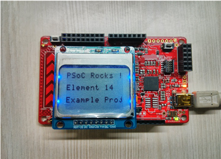

Hello!
Today’s example we are showcasing how to interface to the Nokia 5110 LCD screen with the PSoC 4 Pioneer Kit. This simple display provides a 84 x 48 Graphics LCD that was used in the Nokia 5110 model in 1998. This example provides a simple example to write text and an image on the LCD screen. This example uses a bit-banging method for sending the data & clock from the CPU to the LCD panel. The project does not require any UDB resources, therefore it can be used with the PSoC 4 (42xx and 41xx families).

The main.c simply calls the APIs defined in the source file for initialization & for displaying the string on the LCD.
In this example, LCD initialization is done as specified in the datasheet of PCD8544 LCD driver which is used in the LCD panel. It is not necessary to use all 8 pins of PSoC 4 for interfacing this LCD. Reset, Chip Enable, Power, Backlight & Ground pins can be connected to fixed voltage levels on the board. Only Data/Command, Data & Clock pins are used for sending the data to LCD.
Hardware Connections:
In this example we are not using any specific headers or shields. Instead we are providing a firmware example to interface with the Nokia 5110 screen. We have connected the screen in the following connections:
Test Your Project:
Connect your screen and program the Pioneer kit. See the screen display the example text and images.
