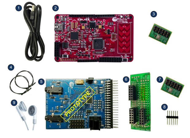

Hello!
In today’s example we are including a demonstration project for supporting Audio playback and audio recording using USB digital audio. The PSoC 5LP communicates with any USB host, provides a high-quality recording interface to it, and extras high-quality digital audio from the USB host. In this example we show the PSoC 5LP device communicating to:
  • Windows
  • Mac
  • Linux
  • Android
  • BeagleBone Black
  • Android
  • iOS
This example project utilizes the PSoC 5LP device on the PSoC 4 Pioneer Kit. This example has the following features:
  • Audio-out (I2S)
  • Audio-in (PDM Mic)
  • USB Host Interface
  • Volume Control
  • Watchdog
The firmware was designed and tested with PSoC Creator 2.2 SP1.

Hardware Connections:
The hardware connections are detailed in the attached zip project. We include the codec board schematics in the documentation folder.
Test Your Project:
Please see the below image of the example in action.

    Matt, Thanks for this post, looks very interesting, BUT I'm having trouble with the hardware connections. POSC4 P5LP header Pin POSC4 P5LP header Name AK4556 J6 Header AK4556 Pin Number CS42L51 CS42L51…
    POSC4 P5LP header PinPOSC4 P5LP header NameAK4556 J6 HeaderAK4556 Pin NumberCS42L51CS42L51 Pin
    VDD1P5 VDDJ6-35/364/5 5/12/27
    I2C_SCL2P1.2 PSOC_CODEC_I2C_SCL3 – SCL/CCLK
    PDM_DATA3P0.0
    LRCLK4P0.1J6-15 (P5-3)14 - LRCKTP113 – CODEC_LRCLK1 - LRCK
    PDM_LR_SEL5P3.4
    SCLK6P3.5J6-13 (P5_5)16 - BCLKTP112 – CODEC_SCLK31 - SCLK
    CODEC_RST7P3.6 TP111 – CODEC_RST25 - RESET
    SDTO8P3.7J6-11 (P5-7)8 - SDTOTP115 – CODEC_SDTO29 – SDOUT/M/S
    PDM_CLK9P12.6
    MCLK10P12.7J6-12 (P5_6)15 - MCLKTP110 – CODEC_MCLK30 - MCLK
    GND11GNDJ6-373 13/28
    I2C_SDA12P3.0 PSOC_CODEC_I2C_SDA2 – SDA/CDIN
    TP114 – CODEC_SDTI
    As you can see I am unable to match up all the pins to the CS42L51, and am not entirely sure of the AK4556 pin connections.
    I'm surprise you used a CODEC with limited availability, and not board support.
    After a quick Google I found Audio Codec PROTO - Development Board with WM8731 Audio Codec which I think does all you are doing with the codec, and is available on a development board in the States for $19?!?
    Nice idea, and nice code, but I'm surprised and disappointed by your choice of hardware.
    OR MAYBE I'M MISSING THE POINT?
    Thanks for all the projects, I've been following since before the 100 days projects, and have a PSoC4 and many of the shields you have demo’ d.
    Well done
    Thanks
    David
    e14 Contributor over 12 years ago in reply to greatunclebulgaria
    David,
              Thanks for your interest with this example project. The pins that are left are the PDM microphone module connections. PDM microphone (ADMP521Z EVAL) is a separate module and is not part of CS42L51 or AK4556 codecs.
    Sorry about using a codec hardware that is not readily available in the market. We couldn't find a codec only development board/shield that suits our requirements.
    We looked at the Wolfson Codec proto board, it doesn't accept an external I2S master clock (which is required for synchronous USB audio implementation) and we couldn't use it for the demo.
    In theory, this example project will work with any codec that supports the following features:
    - 24-bit I2S slave interface (PSoC 5LP is the I2S master)
    - Accept external I2S master clock (PSoC 5LP supplies the I2S master clock that is in sync with USB SOF) of  256 * Fs (Fs = audio sampling frequency)
    -Krishna
