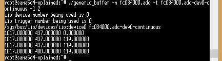

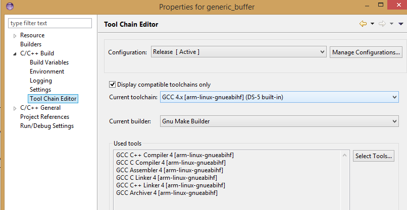

    0 Jan Cumps over 11 years ago in reply to noglitch
    Success !!
    I've uploaded this image:
    ftp://www.at91.com/pub/demo/linux4sam_4.7/linux4sam-poky-sama5d4_xplained-4.7.zip
    I did use a different generic_code.c, just downloaded the one from https://github.com/linux4sam/linux-at91/blob/master/drivers/staging/iio/Documentation/generic_buffer.c
    (raw version:https://raw.githubusercontent.com/linux4sam/linux-at91/master/drivers/staging/iio/Documentation/generic_buffer.c)
    I'm using the GNU toolchain that comes with DS-5 Community Edition
    Invoking: GCC C Linker 4 [arm-linux-gnueabihf]'
    arm-linux-gnueabihf-gcc -static -marm -march=armv7-a -o "generic_buffer"  ./generic_buffer.o
    Loaded to the board, and this is the result:
    root@sama5d4-xplained:~# ./generic_buffer -n fc034000.adc -t fc034000.adc-dev0-continuous -l 2
    iio device number being used is 0
    iio trigger number being used is 0
    /sys/bus/iio/devices/iio:device0 fc034000.adc-dev0-continuous
    1017.000000 437.000000 0.000000
    1017.000000 437.000000 119.000000
    1017.000000 400.000000 119.000000
    Thank you!
