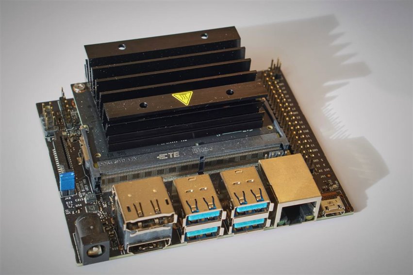

The NVIDIA Jetson Nano is a compact board approximately 70x45mm in size, with a large heatsink : ) It's got a very powerful microchip, the NVIDIA Tegra X1, which contains four ARM applications processor cores, as well as 128 graphics processing units (GPU). GPUs are used for more than graphics purposes, because it turns out that some of the interesting applications for computers today, to do with neural networks, which can be used to recognise patterns with ever increasing accuracy, can be created more easily and can perform better as the number of processing units increases. The full version of the Tegra X1 (with twice as many GPU cores) is designed for some quite diverse applications, including gaming but also automotive use, where it can support automated parking, stitching of video from multiple cameras and in-driving assistance (such as lane control, passenger avoidance and driver alertness monitoring).
The Jetson Nano comes as a small outline dual-in-line memory module (SO-DIMM) form-factor, already plugged onto a compact 100x80mm carrier board, together forming the Developer Kit. The carrier board has many typical computer interfaces on it, like USB 3.0, Gigabit Ethernet and video (4k 60fps capable!). There are also connectors that are very similar to those on the Raspberry Pi. There's a 40-way expansion connector that is almost identical in layout to the Pi's connector. A Pi camera is also supported.

    Just a couple of quick corrections - the Tegra X1 is a quad core A57 on the Nano and the Nano only has 128 GPU cores.
