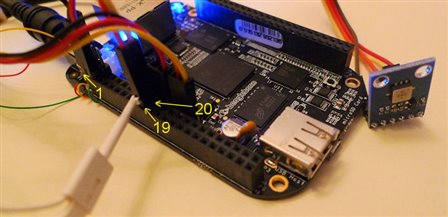

I2C turns out to be fairly easy and straightforward on the BBB.
There are three I2C busses (I2C0, I2C1, I2C2), of which I2C2 is easily usable (Expansion port P9, see table 11 in the SRM).
I2C0: used for some on-board components (HDMI, EEPROM, power mgmt). Not brought out to any connector/header
I2C1: entirely free to use, but doesn't seem to be enabled
I2C2: entirely free to use, and works
NOTE: In software, the busses are numbered differently; I2C2 is identified as 1. I2C0 is identified as 0.

By default the bus appears to run at 100kbps approx.
I created a test program using the nearest I2C device at hand (which happened to be a BMP085 temperature and pressure sensor),
it is part of the zip contents.
root@beaglebone:~# ./a.out
Temperature is 23.6 degrees C
Pressure is 101.027 kPa
I noticed it is not possible to control the power mgmt ic using the code, since presumably it is a protected resource.
I2C2 on Expansion header P9:
pin 19: SCL
pin 20: SDA
pin 1: 0V
pin 3: 3.3V
