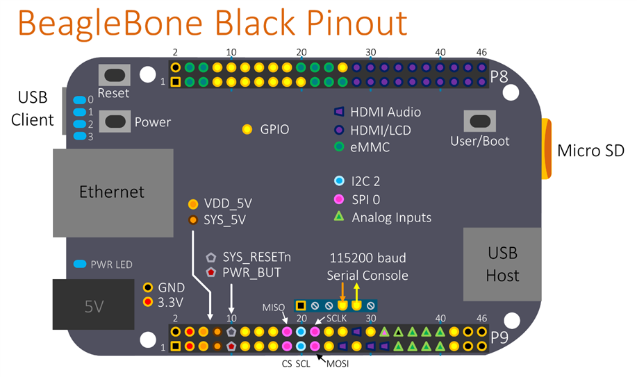

This blog post describes a C library called iobb, that allows for easy general-purpose input/output (GPIO), SPI and I2C using the BeagleBone Black (BBB) and other BBB variants such as the BeagleBone Black IndustrialBeagleBone Black Industrial and BeagleBone Black WirelessBeagleBone Black Wireless. This library is also PocketBeaglePocketBeagle friendly. If you’re using the PocketBeagle, then read on through to understand how the library works, but then check out the section near the end, titled PocketBeagle Specifics for the specifics : )
This library is designed to be easy-to-use, it is quite simple, and it allows for reasonably speedy I/O. There is plenty of demo source code too.

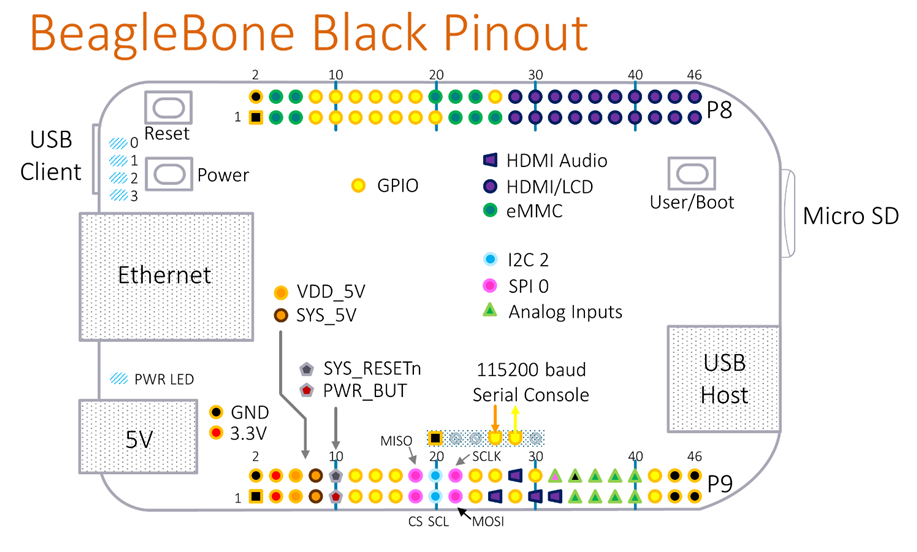

The diagram here shows the pins that are available to be used by default. All the yellow pins can be used as general-purpose input/output, and the pink SPI pins can be used as general-purpose I/O too, if SPI functionality is not needed. Pink and blue are SPI and I2C buses respectively. This is a simplified diagram, it is possible to use alternative pins too.

The code uses connector P9 (only P9 is available for SPI) with these pins:
P9 SPI 0 PinDescription
17SPI 0 chip select (CS)
18MISO (i.e. data input to the BBB)
21MOSI (i.e. data sent from the BBB)
22SPI SCLK

Which pins can I control with the GPIO, I2C and SPI functions?
On connector P8, the following pins have been successfully tested:
Pins 7, 8, 9, 10, 11, 12, 13, 14, 15, 16, 17, 18, 19, 26
On connector P9, the following pins have been successfully tested:
Pins 11, 12, 13, 14, 15, 16, 17, 18, 21, 22, 23, 24, 26, 27, 30, 41, 42
Note that if you want to use SPI, then keep P9 pins 17, 18, 21 and 22 free for that.
For I2C, P9 pins 19 and 20 are used. Other options are possible for I2C and SPI pins, but I have not tested other pins.
Also, note that when the I2C or SPI functions are used, then the library automatically configures those pins, and they cannot be reused for GPIO read/write functions. This is based on the assumption that if hardware is connected to use I2C or SPI, then it is unlikely that the pins will be needed for GPIO. However if you wish to use those pins again for GPIO, either reboot the BBB, or alternatively type this from a command prompt, for each pin that was used:
config-pin P9_17 gpio
The config-pin utility is part of all new Linux builds for the BBB, and it can be used in a few ways (this is just informational; it is not necessary to do this to use the library). For instance, if you type config-pin -l P9_17 then it will list all possible modes of operation for pin P9_17. The current mode can be queried using config-pin -q P9_16 .

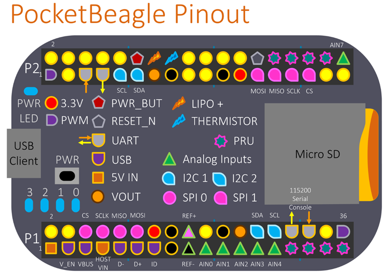

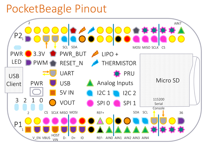

The library is used in much the same way as described above for the BeagleBone Black, but there are a few fairly self-explanatory differences. For instance, any function described above call that uses the number 8 or 9 to represent header pin connectors P8 or P9 on the BeagleBone Black, are replaced with 1 and 2 for the PocketBeagle to represent connectors P1 and P2.
The diagram here shows all the pins available. The yellow pins can be used as general-purpose I/O, so (for example), to set connector P1 pin 4 as an output and to set it high, use these lines as part of your C code:
iolib_setdir(1, 4, DigitalOut);
pin_high(1, 4);
Unlike the BeagleBone Black, the PocketBeagle by default has more I2C and SPI interfaces available.

Here is a table of the pins that need wiring up if you’re using SPI on the PocketBeagle:
For SPI 0 on connector P1:
P1 SPI 0 PinDescription
6SPI 0 chip select (CS)
10MISO (i.e. data input to the PocketBeagle)
12MOSI (i.e. data output to the PocketBeagle)
8SPI SCLK
For SPI 1 on connector P2:
P2 SPI 1 PinDescription
31SPI 1 chip select (CS)
27MISO (i.e. data input to the PocketBeagle)
25MOSI (i.e. data sent from the PocketBeagle)
29SPI SCLK
I2C with the PocketBeagle
Using I2C with the PocketBeagle is very similar to the BeagleBone. The only main difference is that instead of using configure_i2c_pins(19,20) (the BeagleBone Black uses these pins on connector P9 for I2C), use the correct values for the PocketBeagle. There are two I2C interfaces on PocketBeagle, one on connector P1 and the the other on connector P2. I2C1 is on P2, and I2C2 is on P1 (i.e. swapped around).
For the I2C interface on connector P1, which is I2C 2:
configure_i2c_pins(28, 26); // P1 pins 28 (SCL) and 26 (SDA)
For the I2C interface on connector P2, which is I2C 1:
configure_i2c_pins(9, 11); // P2 pins 9 (SCL) and 11 (SDA)
Since the PocketBeagle by default has both interfaces configured for I2C anyway, the configure_i2c_pins function is optional and doesn’t need to be used.

Here is a summary of the pins that need wiring (don’t forget to use pull-up resistors of about 4.7k ohm, if they are not present on the attached I2C device circuit board):
For the I2C bus on connector P1 (I2C 2):
P1 I2C2 PinDescription
28SCL (I2C clock, requires external pullup)
26SDA (I2C data, requires external pullup)
For the I2C bus on connector P2 (I2C 1):
P2 I2C1 PinDescription
9SCL (I2C clock, requires external pullup)
11SDA (I2C clock, requires external pullup)

The diagrams below are printer-ink-friendly versions of the earlier diagrams in the blog post.

    I use SPI0 with CS0 P9.17 for control a ADC. It work vary well.
    I want 3 additional chip select pin using CS1=P9.15, CS2=P9.13 and CS3=P9.11. Another 3 ADC, one CS each.
    Does anyone have a solution to this problem?
    iolib_init();
    configure_spi_pins(17, 18, 21, 22); // CS, D1, D0, CLK //It is OK
    configure_spi_pins(15, 18, 21, 22); // CS, D1, D0, CLK //It is KO
    if (spi_enable(SPI_BUS))
    spi_ctrl(SPI_BUS, SPI_CH0, SPI_MASTER, SPI_RX, /* use SPI_TX or SPI_RXTX depending on needs */
    SPI_DIV32, SPI_CLOCKMODE3, /* 48 MHz divided by 32, SPI mode 3 */
    SPI_CE_ACT_LOW, SPI_OUTIN, 16); /* D0 is output and D1 is input, 16-bit transactions */
    have you correct dts file?
    I need to command four identical ADCs that I have on the board, all with SPI0 and each with its Chip Select.
