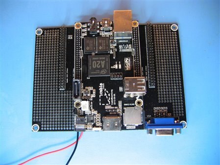

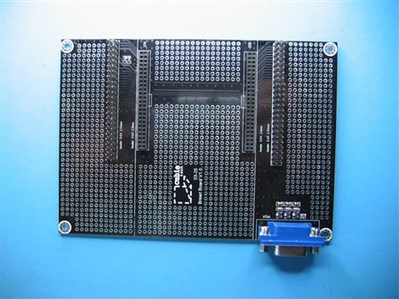

I also got a prototype board to make getting at the GPIO pins a bit easier

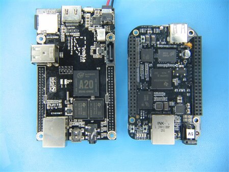

Physically it's a bit bigger than the BBB

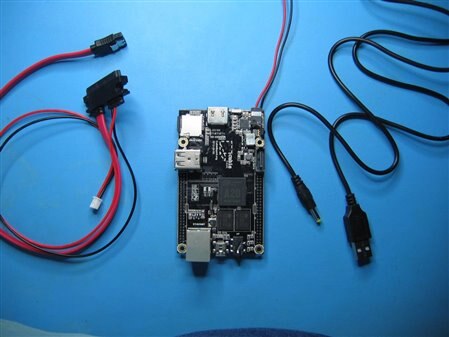

In the box you get a usb to minature barrel connector power lead and a combined sata + power lead that's only really suitable for 2.5" drives due to the lack of 12v
It comes with a version of Android pre-installed on it's 4G nand flash that allows you to have something up and running a few minutes after opening the box.

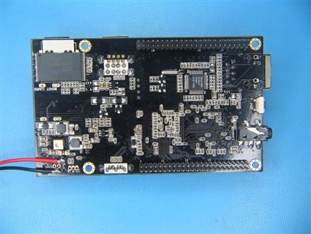

As you'll see in the photos, I've soldered on some relatively heavy power leads, partly due to some concern that the rather flimsy power lead was causing the display problems due to low-ish voltage and partly to make it easier to do some current measurements.
With nothing connected, current peaks at around 360mA during boot and then settles to ~200mA when idle. This is reasonably impressive considering it's running the performance cpu governor and so isn't benefiting from power savings in the way the BBB does.
Connecting ethernet raises the idle current to ~250mA
Adding a CPU intensive task adds approx 100mA per core, peaking at around 460mA
With a 500Gb 2.5" drive plugged in and active it's possible to get up to about 1A if you're stressing everything simultaneously.

    yes, the prototyping board is all 0.1" apart from the 2mm headers for the cubie itself. I'd imagine it'll be ok as a desktop, only seems to be one A20 desktop image so far, I'll maybe give it a try, but…
