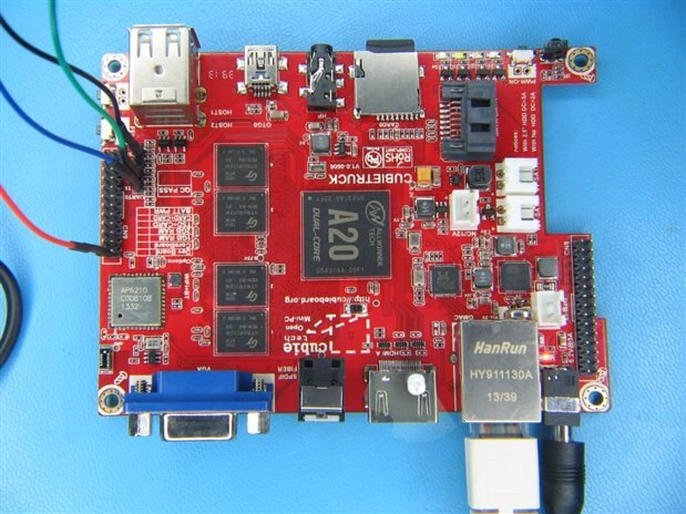

    cubieboard A20
    transmit:
    113.3673 MB /  10.07 sec =   94.4586 Mbps 12 %TX 10 %RX 0 retrans 0.56 msRTT
    receive:
    112.5225 MB /  10.05 sec =   93.9224 Mbps 0 %TX 30 %RX 0 retrans 0.59 msRTT
