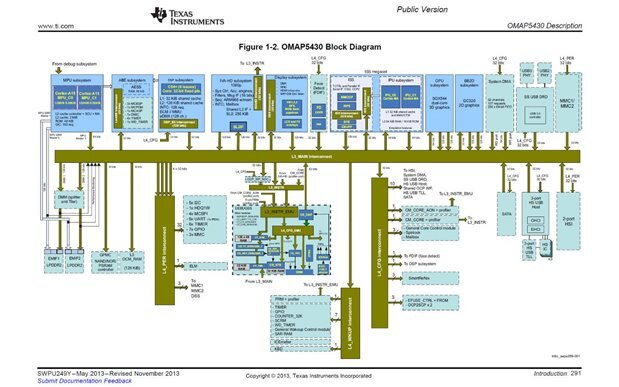

    morgaine wrote: two Cortex-M4 cores in OMAP5 interface to the dual Cortex-A15 A new competitor in the OMAP5 space has just been released by nVidia, the Tegra K1 featuring quad+1 Cortex-A15 CPU cores…

    As an aside, back when we discovered that OMAP5 has replaced the two PRUs of AM335x with two Cortex-M4, it did occur to me that if they'd dedicated the same number of gates to adding more PRUs instead, OMAP5 would have its own integrated array-of-cores, a bit like Parallella. image
    Morgaine.
