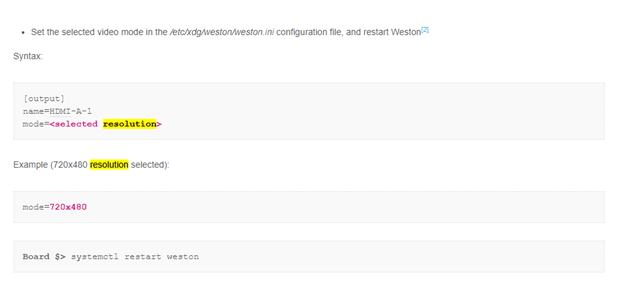

    Hi labi, Looking into this I was successful in changing my resolution to 720p. I unfortunatly don't have a 4k monitor on hand to try it at 4k. I followed the following info and applied it to the MaaXboard…

  • jafoste4
    0 jafoste4 over 6 years ago
    Hi labi,
    I followed the following info and applied it to the MaaXboard https://wiki.st.com/stm32mpu/wiki/How_to_display_on_HDMI
    In particular i modified the weston.ini file mode section and then restared the system using systemctl restart weston
    let me know if this helped
