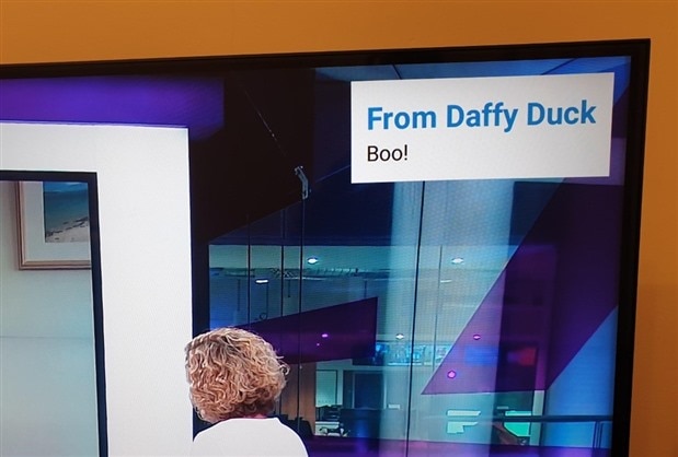

    Just thinking, although you've specified a specific method (HDMI overlay), if actually that's just an example and you don't mind a different implementation to reach a similar-ish end result, then there's another option - it won't work on all TVs though.
    Since a lot of TVs are now 'smart TVs' you could investigate what options there are for using code to interact with the TV. Even if the TV is not smart, there are HDMI sticks to enable that (Amazon Fire etc).
    An example method might be one of the video or picture casting methods, although they will take up the entire screen. If you're have Android built-in to the TV then it is even easier, since you can write a custom app. Or, there are ready-made apps like PiPup. If you install it to your TV then you send custom messages using HTTP and it will appear as an overlay in a box in the corner.

    0 shabaz over 6 years ago in reply to beacon_dave
    Interesting item! I don't know if TV programs still do the corner indicator, so the overlays could get smart in some manner too, using image recognition and then have context-sensitive overlays that only interrupt for low-pri messages during ad breaks!
    I just tried the PiPup app, and it seems to work even if the TV is turned off and on, it still functions without needing to relaunch the app. But it was just a quick 5-min test, I didn't try a full reboot or mains plug disconnection, so really it was in standby.
